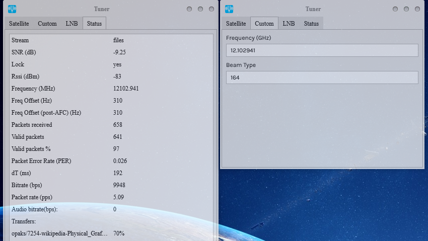

@kenbarbi On mine, optimal according to Jim @ac8dg’s calculation, 12.10296 actually has the offset switching from -37 to 37 (a little too close, maybe.) 12.1030 is probably close enough.

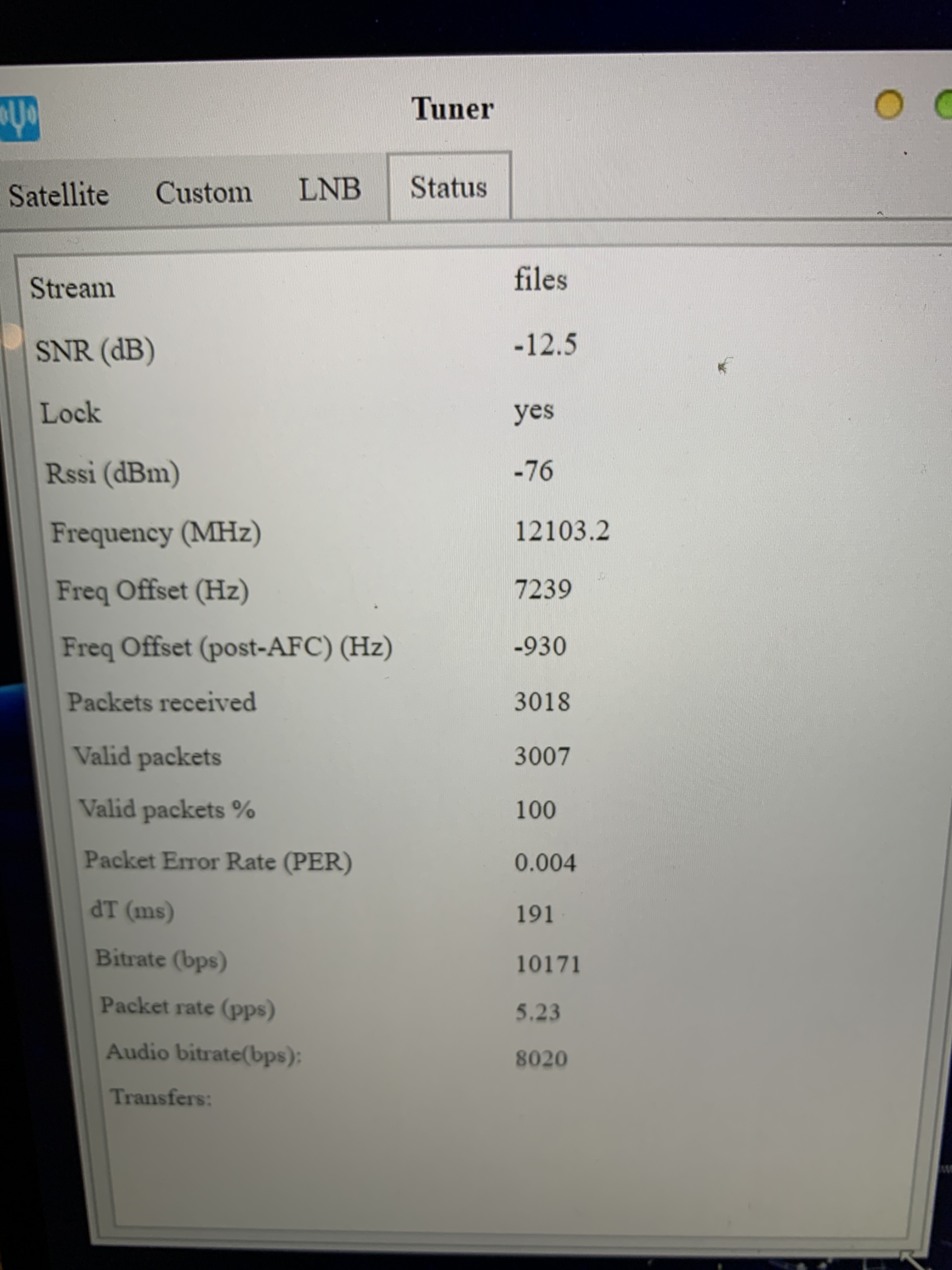

Still using Maverick I. Just tried the way Jim was doing it, and ended up a bit lower in frequency. Look at my status screen.

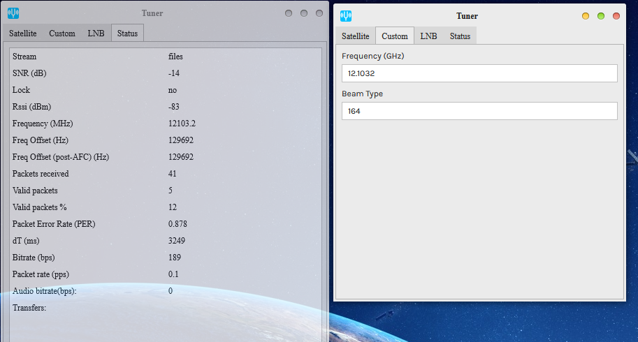

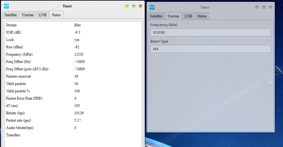

i have to confirm that 12.1030 GHz works compared to not working with the 12.1032 GHz frequency see down below my snr numbers with the maverick LNB
This is receiving indoors with a 35cm dish.
When I was using a generic LNB outdoors, I had -14 SNR, but zero valid packets, due to the large offset.
with some more tweaks to the frequency i was able to drive the offset way down to under a thousand
