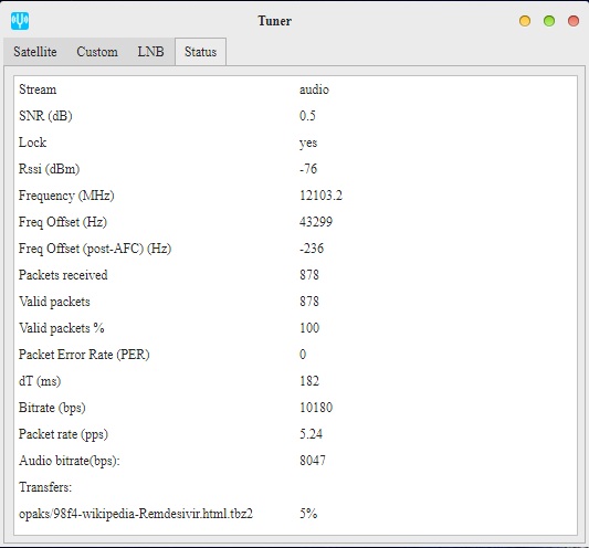

Ok, success after several reboots of Skylark 5.7 and the DreamCatcher.
SNR was 8.0 on freq. 11904.2
Now SNR is now -.5 on freq. 12103.2
No lock.
Dish is still locked down in previous position…

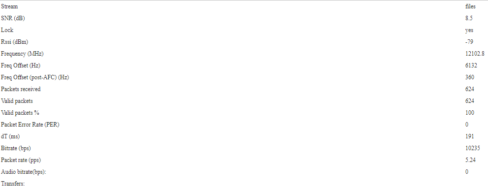

Freq. 12.1028 gives 8.0 SNR and lock in Chicago.
Bitrate 10251
Packet rate 5.26
Audio bitrate 8093
RSSI -70
Finally got it working after a reboot; it’s working well so far.

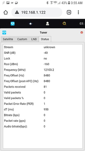

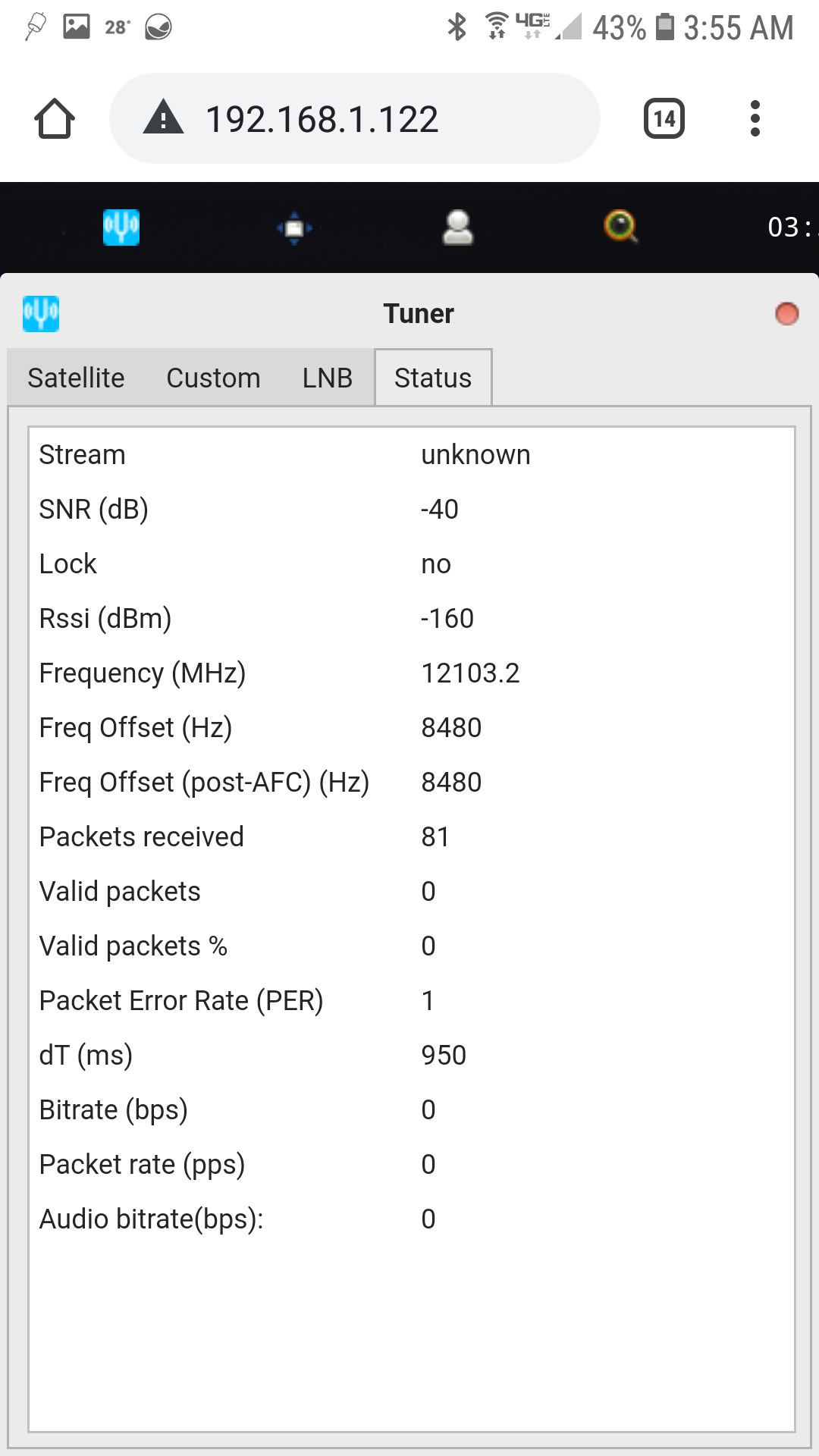

I just made the change. I have no lock. Before the change I had snr of 5.5, so the dish should be positioned properly.
An rssi of -160 is a “very” weak signal, I am surprised you even detected 81 packets, since none were satisfactorily decoded as valid, I would try changing the frequency up and down ( for example downward to 12.1030 , 12.1028 or up 12.1034 , 12.1036 )

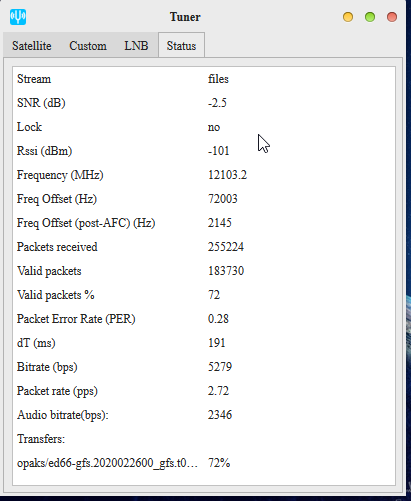

Signal levels here in Annapolis, MD, are fluctuating as is Lock and SNR. Files are arriving, but Valid packets are 72 % and Bitrate is only about 5,000 bps. No audio is coming down. I am still operating on the Dual Band LNB as the Maverick can’t lock to a signal unit at this time. Ken

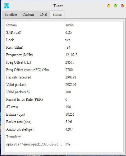

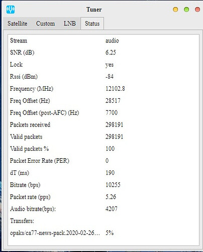

Frequency 12102.8 produces 100% valid packets and SNR of > 6dB.
Tried varying the frequency up and down but 12102.8 is where I get consistent lock. Initially had some audio issues but now working.
Overnight results –
I am used to having to change the custom frequency since I use a variety of LNBF units, some vary considerably with the ambient temperature. This beam type 164 seems a little more “picky” about the set frequency before the AFC correction is satisfactory to lock and have valid packets.
Amazing. I just changed my Custom frequency to 12.1028, and got immediate lock and -6.25 SNR! RSSI is -92. Green balloon is back!
