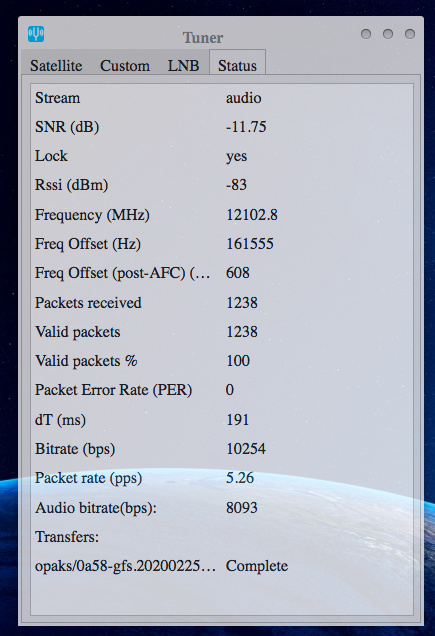

With frequency set to the new specified 12.1032 GHz, I had SNR worse than -15 and was capturing only about 10% of the packets.
I have a DreamCather 3.03, and the Mk1 LNB with a small foiled cup on it. On the fringe in Vancouver BC. About 5 deg C outside.
After I changed the frequency setting to 12.1028 GHz (as shown by others in this forum), my reception is now very acceptable:

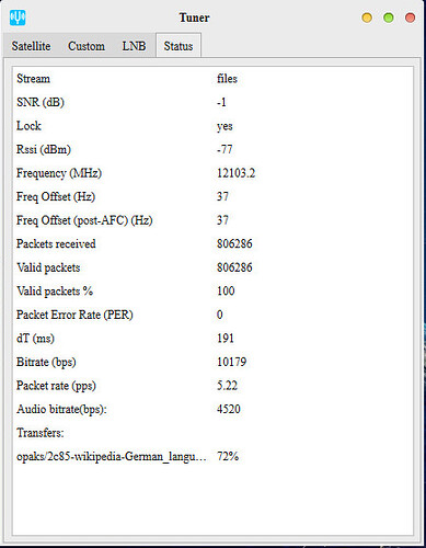

These are my results since just before noon on Tuesday. Like others, it took a couple of reboots and some fiddling around to get everything in order. Setup is DreamCatcher 3.03, Maverick MK1-PLL and the indoor-mounted 35 cm antenna recently offered by Syed. Beam type is 164.
I think it is important to mention that I have the LNB attached to a DirecTV phase III dish, normally get a signal between plus 6-7
Currently at 6.5 no adjustments to the dish from frequency and type change were needed.

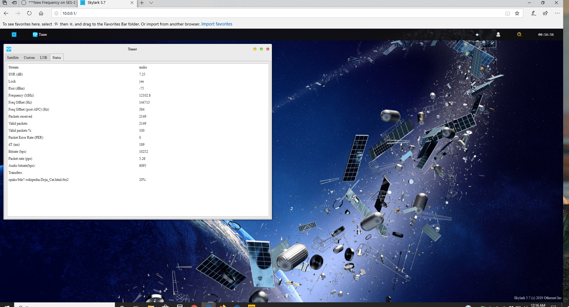

Skylark V5.7

I got the Maverick-1 to work again, but Rssi is about the same as with the Dual-Band, around -86. It used to be about -70 before the freq change. It now seems the new beam of 164 may not be firing towards the US as well as before frequency change. Right now I’m on 12.1028 instead of 12.1032 GHz. Seems OK. Too many variables again: Freq, Beam, Rssi, maybe antenna alignment, TP RF power out from SES, who knows. Hope your setup gets better soon.

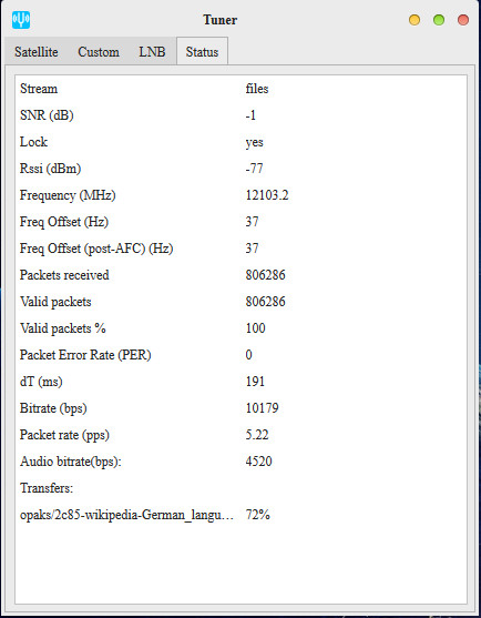

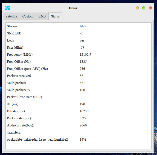

12.1028 was 100 kHz low. here’s where i am tuned now with the dish indoors:
So, we should tweak frequency in the downward direction not lower than 12102.9 MHz if it seems necessary to get lock and good packets.
And use the the Dual-Band LNBF instead of Maverick. Got it.
