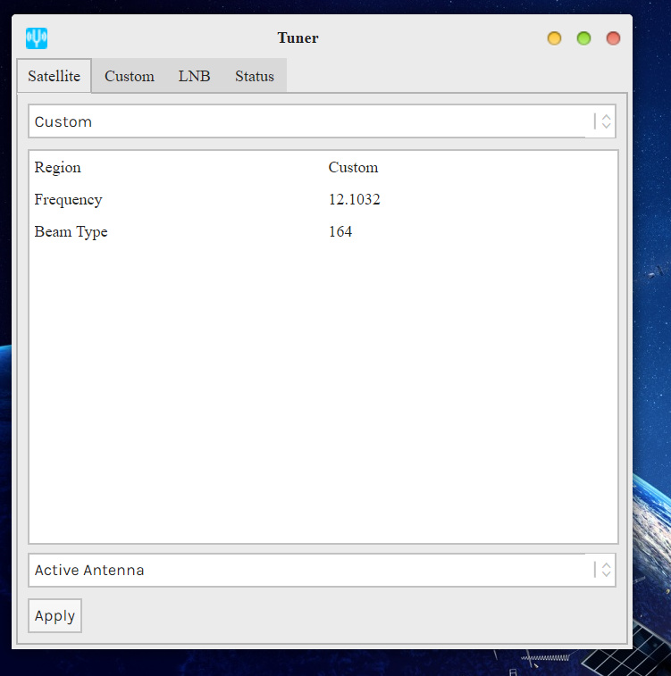

Please manually change the frequency in the Tuner app to 12.1032 GHz
Don’t forget to switch back to the first tab of the Tuner app and click Apply.

The confusion here is the Custom Screen will reflect the new freq of 12.1032 with beam type 228 that you’re changing. But when you go back to the Apply Screen (before pressing the Apply Button), it will show the old freq and beam type, but that’s not the final solution.
You must go back to the Satellite Tab and select Custom before you hit the Apply Button to apply the new Custom settings. Ken

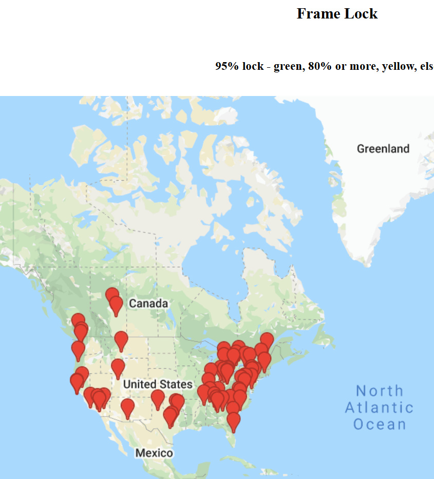

I will watch http://status.othernet.is/ and wait until chicago goes green
Ok, the frequency change is done. Please be sure to change the beam type to 164. Let us know whether your SNR has changed significantly.

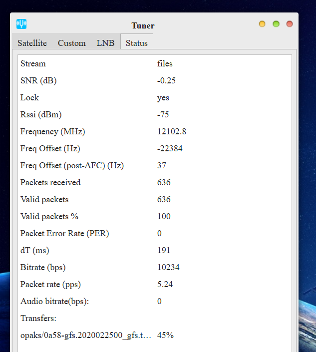

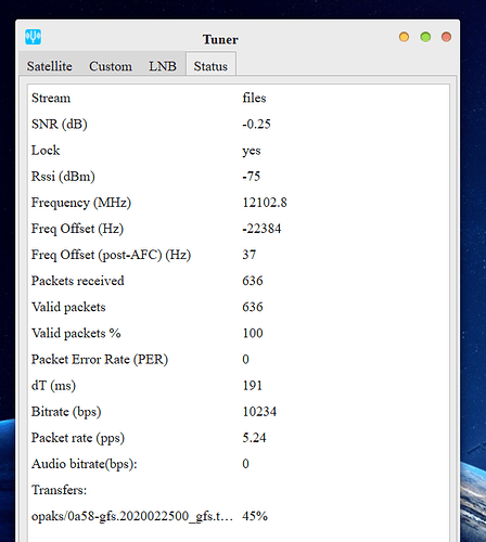

Had to tweak my tuner freq a little, here are my two systems, with a lock
time : 12:54 EST 2/25/2020 still checking snr (about the same)
time:1303 EST, audio started, dropped snr by 2 dB overall
80 cm dish:
18 in dish

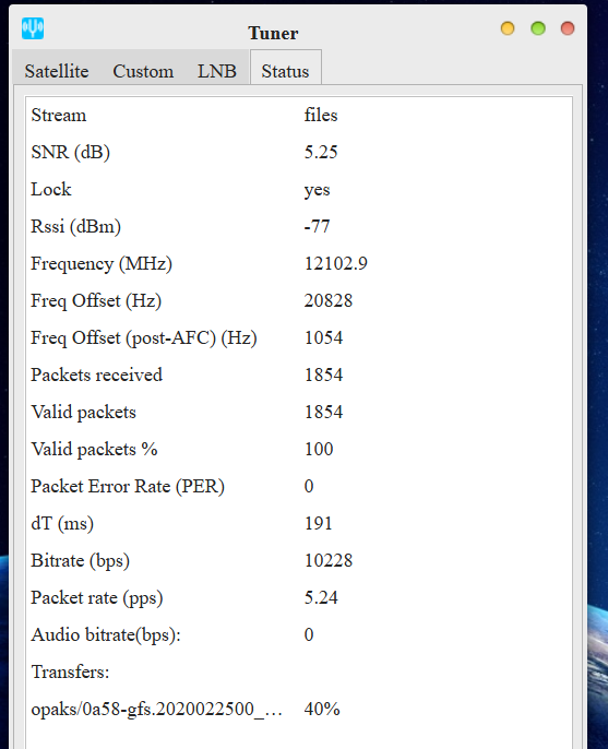

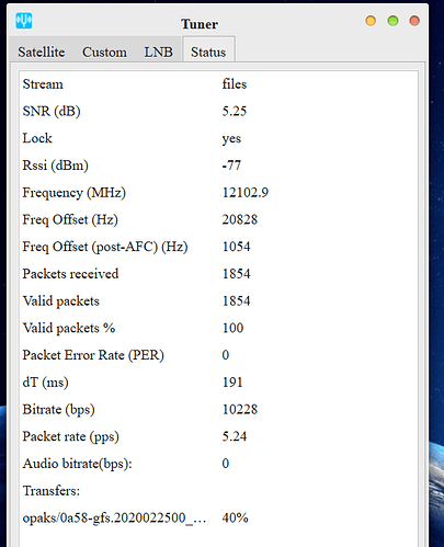

SNR didn’t change from the old frequency but (per ac8dg’s experience) had to use 12.1028 as would not lock on 12.1032. May tweek further.
Here are the results:
