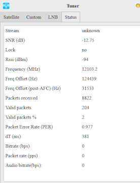

My SNR with the MotoSat dish is horrible, running at -13 to -14 on average after the changes. RSSI down to -94.

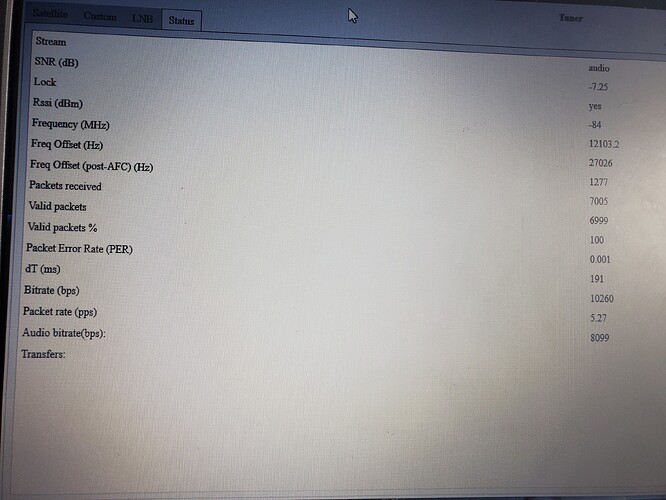

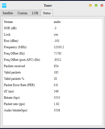

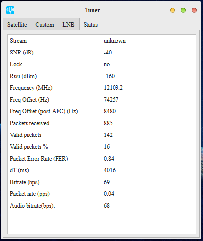

Can you send a screenshot of the Status tab?
Status Tab
It wavers between a LOCKED signal and no signal

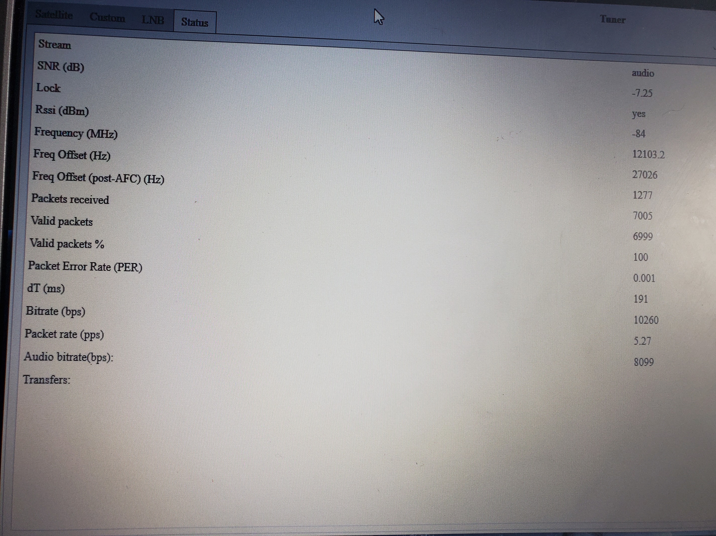

Here is mine:
