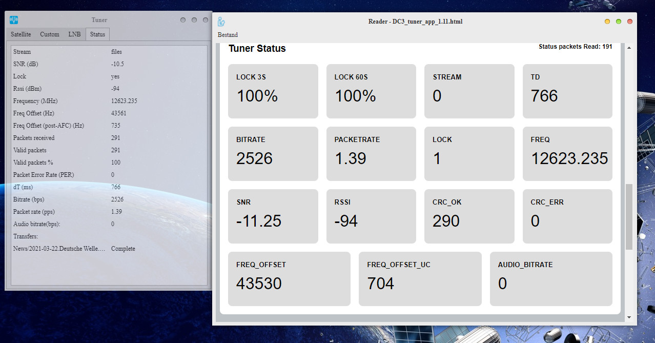

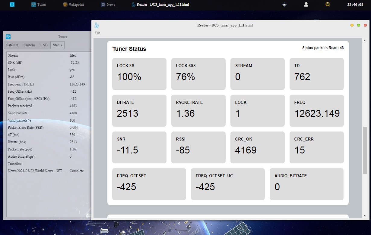

So it’s running now, run the auto tune en freq files. Another freq. Is this ok from Europe?!
Your Frequency is not correct, see the FREQ-OFFSET field, please set to 12623.280 and see what FREQ-OFFSET says, maybe the LNB drifted after auto search (or something didn’t work)

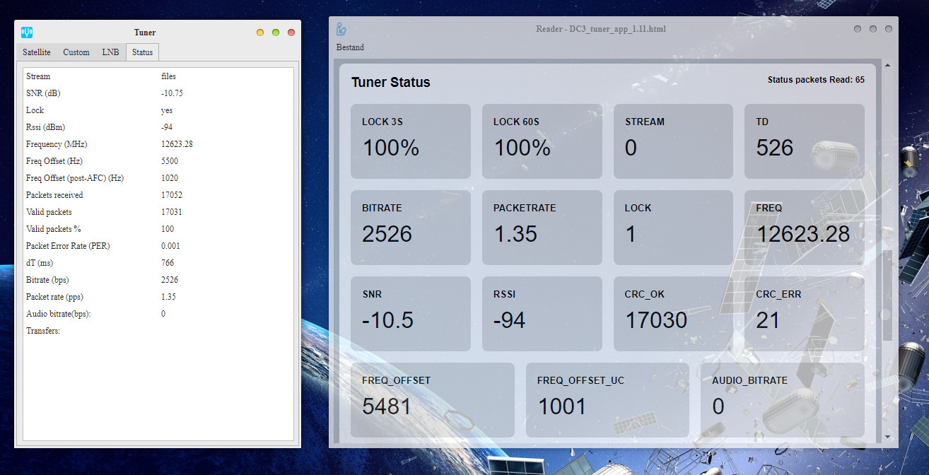

Frequency i perfect, good Job! Still curious why your SNR is so low, but hay it works so all is good.

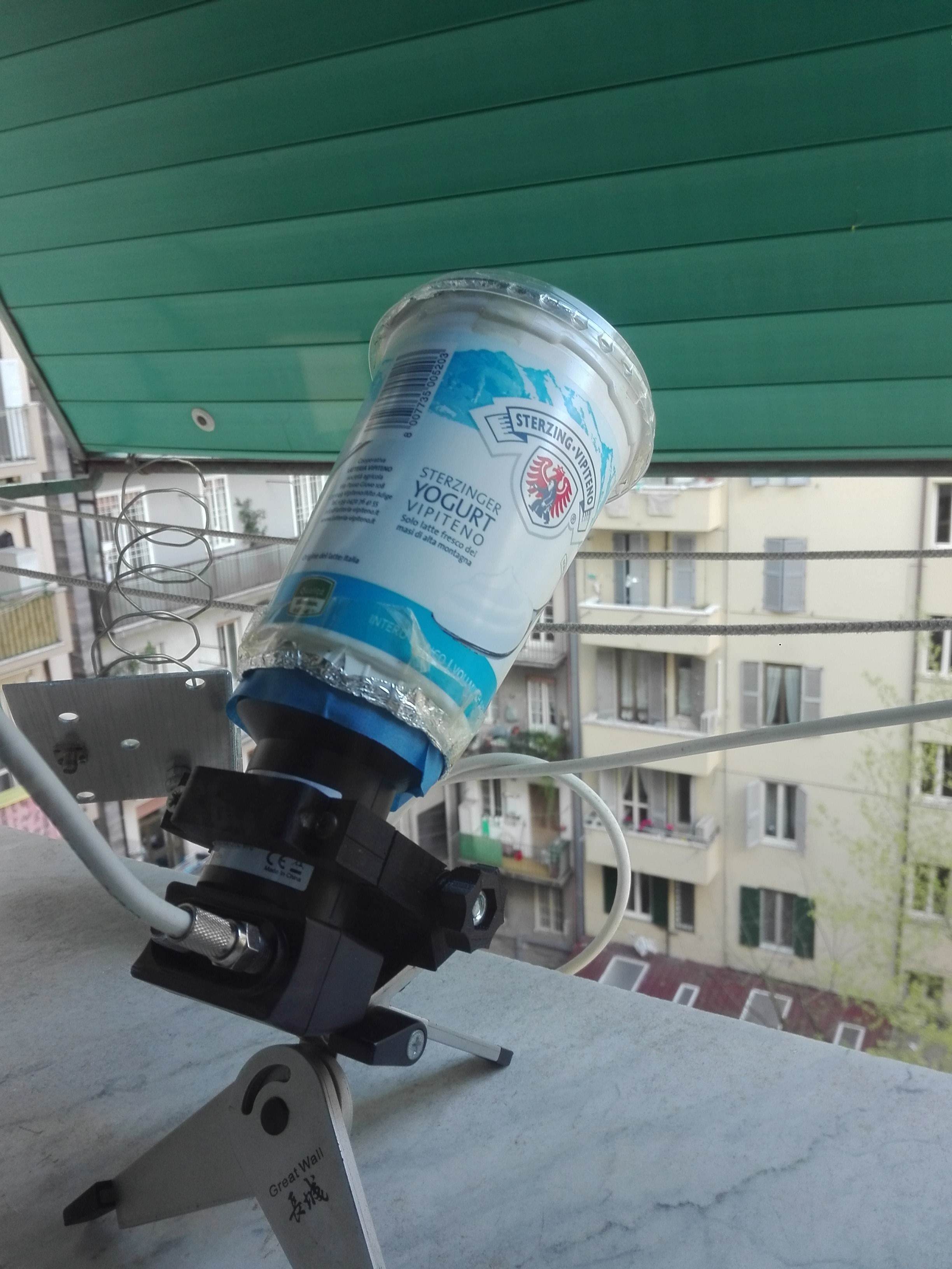

I took a closer look, it’s an SMA cable with a few (un-)reverse adapters in between. These connectors are waterproof to a certain degrees by design. Only the last adapter to F-Connector should really be sealed, so there’s no water ingress into the Bullseye, which will destroy it over time. Thats what the rubber rings are for in my photo, but you can do it with vulcanising tape around the outside too.
maybe white yougurt is not the best for othernet? or the 9 floors building in front my window?
Have 11/12 in the snr field is good with this setup. :+1:
i know what your Problem is i think, what is that green thing on front of the LNB? Is it a Window or some sort of sun protection? At these Frequencies anythign between the LNB and the Satellite will reduce your Signal a lot.
Yes, and inside tihs " curtain" have also iron rods. This are the worst (?) conditions I test the LNB on othernet beam. Sort of attenuator

For antenna work its good practice to wrap exposed connectors in self amalgamating PVC tape, This prevents the ingress of water and prevents corrosion of the metal. Rain gets into the co-ax and spreads by capillary action or in the case of air spaced co-ax down the airway like a pipe and corrodes the copper.
I’ve been setting up antennas and looking after a CCTV distribution system for some time and taping exposed metal connectors is essential and the tape is cheap. The time spent replacing corroded stuff is not.
yeah that is really Bad, if you can try and move it so it has a clear view to the Sat, with that your Can will not be needed anymore i would say :slight_smile:

What worked for a Year will work for another yeay, i do protect my Hamradio cables a lot better, but repalcing a 30cm Window Pass-Trough cable is a lot easier as well then a 10m+ cable for a Hamradio Antenna :slight_smile:

I did once delay putting tape on a LNB, it rained in the night and did it the next day and the connection subsequently failed due to corrosion as water had got in the cable. I also live near the sea and there is salt in the air which helps corrosion.
I have a clear view of the sky from 28e to 100w but there is this one tall building at 8w …

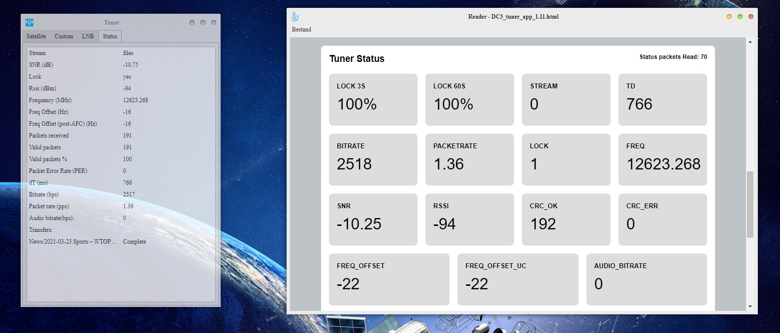

I changed the freq, is it ok or is the LNB the issue?
looks way better :slight_smile: Maybe +5khz (FREQ_OFFSET says around 5khz offset) , so set it to 12623.285, then FREQ_OFFSEt should be under 1000
No roller shutter, 2 db better
