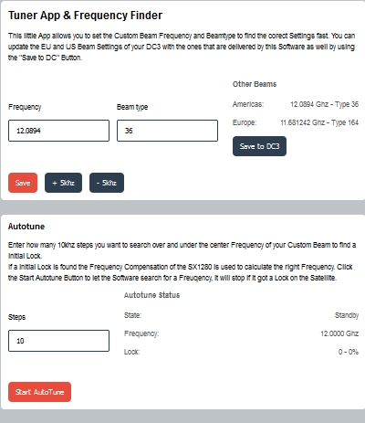

Step 5a. Automated Process Forum member @Tysonpower has also developed an App for Skylark now in the downloads:////Apps Folder Fig. 22 that automates the above process and is shown in Fig. 21a. You can also download it from @Tysonpower 's web site at DC3 Frequency Finder
Fig. 21a Frequency Finder App Version 1.1

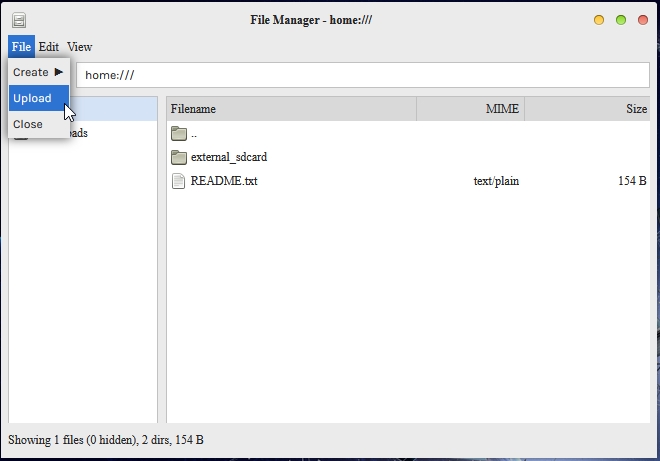

If you chose not to run the APP from downloads:////Apps Folder, but rather install the APP in your Skylark program, you must use log on Othernet (Guest won’t work). You can then upload it to your Skylark Program micro SD card or to your external micro SD card from your computer. Keep in mind if you upload the file into the home:///directory , it gets deleted when you reboot your Dreamcatcher so you would have to reinstall it. If you have external storage, upload it there to keep it permanent. When you run it, it takes some time to complete, so watch its status timer.
You will need to find the file to upload on your computer after you click the Upload TAB

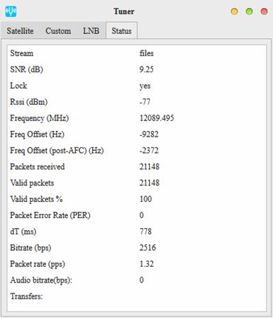

As you approach the optimum Freq, your flashing Status Screen will start showing no Lock with fluctuating SNRs and Rssi (or maybe going in and out of Lock). When you get consistent Lock, take a look at the Freq Offset (Hz)
In this example, we started at 12.0894 GHz and got Lock at 12.089495 GHz after 19 trys. The Freq Offset (Hz) shown above requires adding another 15,193 Hz more to this 12,089,495,000 Hz to get a final Freq setting of (12.089495 GHz + .000015193 GHz) = 12.089510193 GHz which will have the least Freq Offset (Hz). It is 12.089510193 we would enter in the Custom TAB now - then click APPLY in the Satellite TAB. If the Freq Offfset (Hz) was negative, you would subtract it. Keep in mind we added almost 100 kHz to our LNB Frequency to get a good link!

Step 5d. The Tuner Status screen in Fig. 23 will show the SNR (dB) line fluctuating at a value above -14 dB (sometimes as high as + 10 dB), the Lock line saying yes , and the Rssi (dBm) line fluctuating at a value between -60 and -95 dBm. Lower Rssi levels such as -100 dBm may carry signal, but the Dreamcatcher is not sensitive enough below -95 dBm. On the top of the Tuner Status Screen, you will see what type file is being downloaded at that moment - - either audio or files . At the very bottom of the screen you will see what file is being downloaded or just finished downloading at any time. This picture represents a successful connection at latitude 39 deg N longitude 76 deg W in mid afternoon with an accurately pointed LNB, and a fine tuned LNB Additionally, LED 6 will be fast blinking dim green if data packets are detected.
Fig. 23 Tuner Running Correctly on SES-2 at Latitude 39 degrees N

please use this Link: DC3 Frequency Finder

yes, no lock, but offset “2120” SNR is -40 db on the satellite dish.
You are using a dish? If so, something is wrong.
Yes, i described the setup earlier. 85cm, pointed and Skew adjusted to +10db on a DVB Signal.
With such narrow beam width from an 85cm dish, you should only be seeing the Othernet carrier. SNR at -40 means that the SX1281 is giving a garbage value. The two garbage values I often see are -40 and -160.
The auto tuner is homing on on the signal, getting better… Im receiving files now.
But it couldn’t lock with offset at just 2120 Hz?
right now it’s strange, the tuner stays at -40, stream ‘unknown’ but files are coming in.
