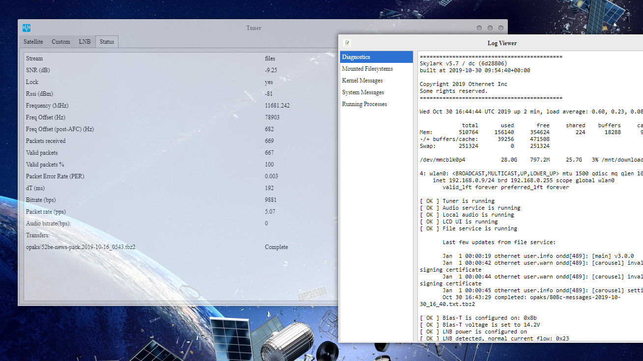

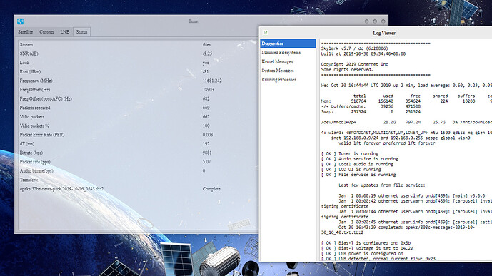

Up and running on both 3.03 and 3.05, green balloons over Utah on the map! This ran great during the tests, with no crashes! I would encourage everyone to move up to Skylark 5.7!

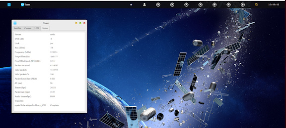

Anomaly (?) Question: Both Dreamcatchers, 3.03 and 3.05 have been up using Skylark v5.7 for five days with no problems. All apps seem to be working and up-to-date. However, as you can see in this screen shot, a bunch of the rotating pluses have shown up to the right of the “heartbeat man” . If one closes the tuner app, the heartbeat man goes away, but the rotating pluses do not. I have not re-booted either unit, and both are displaying this behavior. I have logged on and off the tuner app in both units numerous times. Did not see this in previous versions of Skylark. Do you see this when logging in remotely at 136.36.137.45 (my v3.05) admin login is othernet/j7m*2 ?
