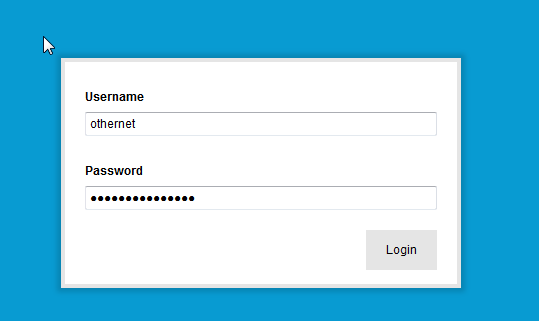

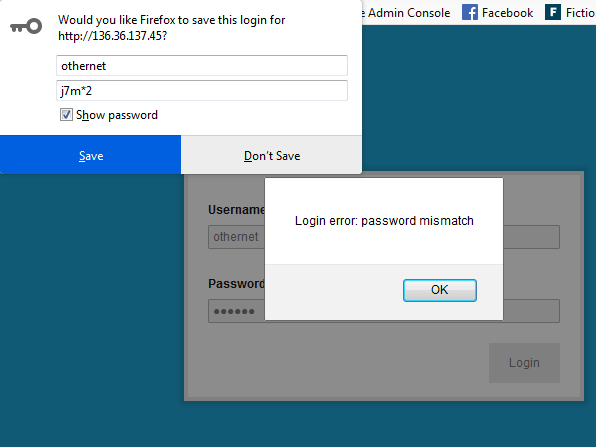

I can get in fine using the guest login, but the othernet admin with your password says login error
The login should be othernet, password j7m*2 sorry for not being clear on that. I don’t know why is isn’t accepting it, that is what I am logged in with. Perhaps part of this anomaly?
Yes - - now I can get in fine. You look fine with the admin login. I just logged in OK. Ken

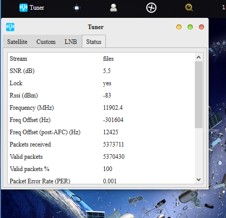

Hi Ken, it behaves exactly as my setup, the rotating plus appears when entering the tuner-app and remains blinking until i close the app. With the other apps it shows only short while loading.

The apps, when they make a “call” to the Skylark server over wifi, show this rotating “progress bar” indicator of sorts. They vanish when the call successfully complete. Tuner app, for example, makes this call about once every second. The wikipedia app makes it only once, when you open the app. The Log Viewer app makes it every time you click on a label in the left column.
Sometimes while this call is being made, we may experience a temporary connection loss over wifi. That causes the call to fail, and the “rotating plus” associated with that call just hangs around. Meanwhile, an app like the Tuner app might give up on the failed call, and initiate another one. Everytime this failure happens you accumulate another “rotating plus”.
These are really just showing failed calls. If too many of them are accumulating, you should check you wifi signal. If you only see them accumulate every once in a while, the easiest way to clean them up is logout and log back in. They serve as a kind of record of wifi connectivity loss.
This is what I thought, in the every day processes, but logout and log back in do not erase them. (I remember that this did work previously, but not so on this iteration, apparently). My WiFi: on the 3.05 is only ten feet away from the TP-Link Archer C7 router, the 3.03 is about 40 feet away, both are acting the same way. Previous versions of Skylark did not do this. Any time behavior changes, I like to let you know, in case it can be fixed in a future OS.
Yes now I see what yo mean and understand what Abhishek says
Each time the Tuner app calls to the Dareamcatcher for a signal update, then the wheel turns an goes away. I have seen a build up of wheels here, but only when I had a problem such as losing my Wifi too. Ken

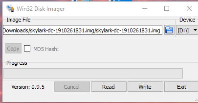

I re read your first message - - Rufus is a reformatting/cleansing program. To insall the Skylark image on the micro SD card, you need to use a program such as Win32DiskImager or Etcher
Say again how you wrote the Image onto the micro SD card please. Ken
I used ballenaEtcher to write the image after using Rufus. The boot LED remained on all night so reflashed with Etcher. After 15 minutes the boot LED is still on. How long should a normal boot take? And how long for a factor reset?

The power LED is lit, and the heart beat LED is flashing… Tried another re-flash, this time with Win32DiskImager but the results are the same. When I tried a “verify only” after flashing it failed at sector 16384, so I wonder if I might have a bad SD card What are some known good brands of micro SD cards? I’m using a Kingston brand. And I’ll see if I can find a shorter cable in town as the 3 footer is as short as I have.
