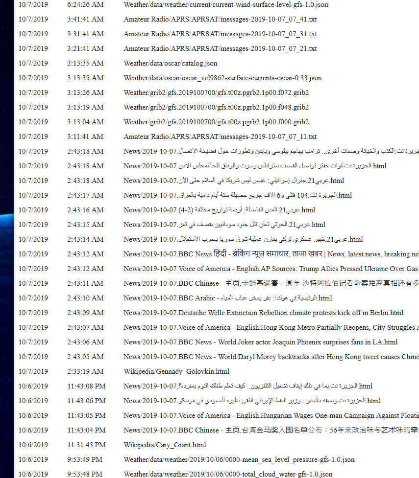

Then what is even stranger, there must have been some files downloaded but not processed
I checked the what’s new on the one that lockedup and several new processed files arrived
note the entires between 11:31:45pm and restart at 6:24:26am
