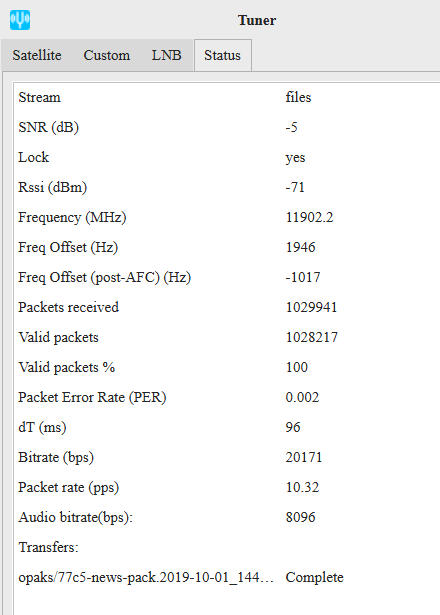

ok, have a lockup on my 3.05 running 5.6,
The led 6 closest to the coax fitting is lock-on solid
It is no longer receiving/decoding packets, the number of packs received has stalled
New this test… I have wifi access to the dc/skylark…

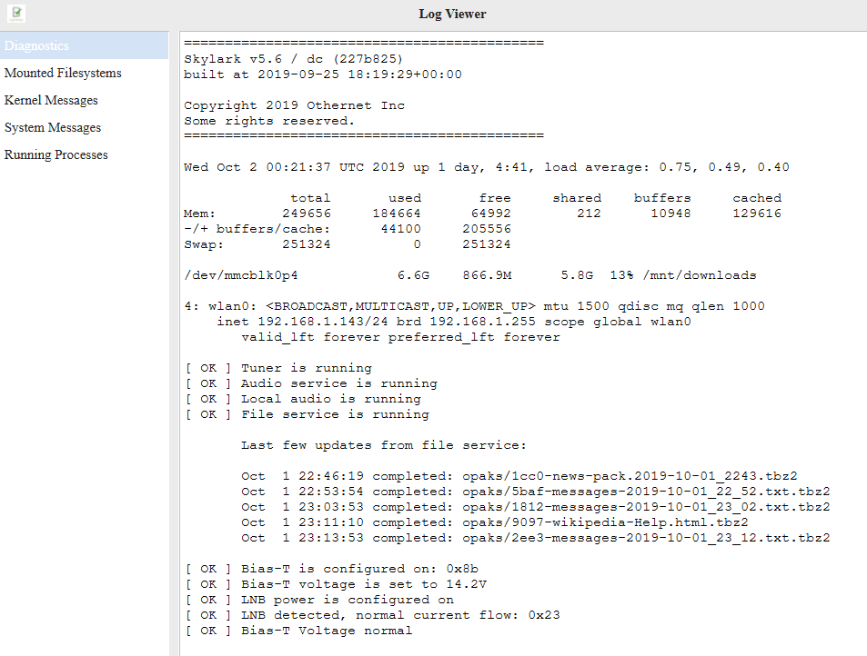

tuner app status page:
then here is diagonstics–
I don’t know what else to show…

diagnistics:
Skylark v5.6 / dc (227b825)
built at 2019-09-25 18:19:29+00:00
Copyright 2019 Othernet Inc
Some rights reserved.
Fri Oct 4 00:28:26 UTC 2019 up 1 day, 12:36, load average: 0.38, 0.52, 0.59
Edit~ 05 Oct 2019-- Better news now up almost 3 days-- no lockups
Sat Oct 5 10:20:28 UTC 2019 up 2 days, 22:28, load average: 0.76, 0.77, 0.72
