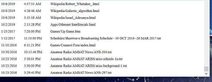

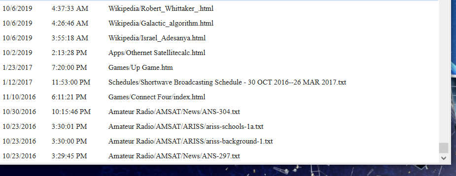

Here is another clue on the freezing v 5.6
Looking at the âwhatâs newâ. There are entries that are NOT being cleared from Whatâs New.
There is a weeks worth of news, messages, weather at the top of the listing , but some entries are real old⌠mostly the wikipedia articles are staying on list forever (not cleaned up weekly)
For example today is 18 October 2019⌠but here is bottom of the whatâs new
10/21/2019 2300 UTC
