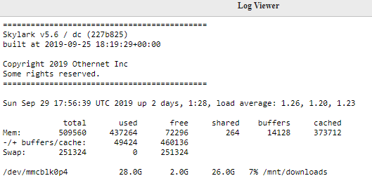

I had a different kind of lock up 12 hours ago. The unit stopped receiving packets, but the Touch Screen worked fine this time. I didn’t notice the LEDs nor did I have the foresight to look at the Diagnostics to see the LNB bias-T status. I’ll do that next failure. Ken

I have encountered the same “lock-up” situation twice since upgrading to Skylark v5.6 on a Dreamcatcher v3.03. The touchscreen is unresponsive and the web server doesn’t respond either.
Yes I had 2 more failures exactly like yours in the last 24 hours. It has nothing to do with the full external storage card which I fixed. Ken
