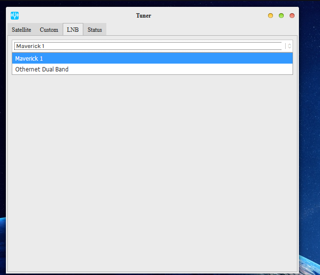

while i was digging in the othernet tuner status i noticed that there is a new antenna setting called othernet dual band is this meaning the new transmission will be a dual band setup to move more data?
@tylerhoot
Tyler, can you post a screen shot here and show us where you are seeing this? It does not appear on either of my DreamCatchers, 3.02Q and 3.03 using Skylark 5.5 [skylark-dc-1901081830.img] under tuner status…
Correction/edit: I see, it is listed as an option under the LNB selection tab. No dual band function has yet been defined for users at this point.
Yes here is the picture its on the LNB tab on the tuner
The dual-band LNB is not for reception of two channels at the same time. It’s to select between high band and low band of the 10.7 - 12.7 GHz Ku-band. The Maverick is a single band LNB which only covers 500 MHz of the upper Ku-band (11.7 - 12.2 GHz).
so in the future we will be having a new transmission and an new antenna for more bandwidth?
No, the new antenna was added because the Maverick is no longer available. They are no longer produced. This new antenna will not impact the download speeds. It does, however, allow a bit of frequency flexibility outside of the US.
