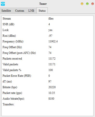

Just an update: the beam is now sending out Audio in the new format. For 5.5 users, things should be running as normal, but audio will no longer work on 5.4 or older releases.
As a side effect of this, in the tuner status, the correct packet rate is about 10.3 and the correct bitrate is about 20,200 bps (used to be 20.5 and 17.6k, respectively).
The audio sounds good and is seems to be of good quality! The specs you quoted readout appropriately on the Tuner App (Packet Rate 10.37,bitrate 20,217) 1554 UTC 11 DEC 2019. Good job again, Abhishek!
Audio is excellent now! Thanks to all the Othernet staff. Ken

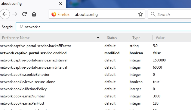

Is there another way to get back into Skylark? I reset my Client Wifis, and can’t get back into the AP mode to set up the Client address. Perhaps thru the SSH? Ken
Am I dumb or something - - the easy solution in Firefox is to turn off Captive Portal Detection in the about:config file. Then I can get into Skylark in the AP mode and make all the necessary changes.

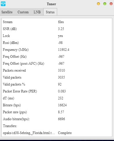

Wifi Interference
I’m revising the post regarding Wifi interference and adding it to this Forum Topic.
After re configuring my local routers, close proximity to the router Wifis caused considerable interference to my Dreamctcher.

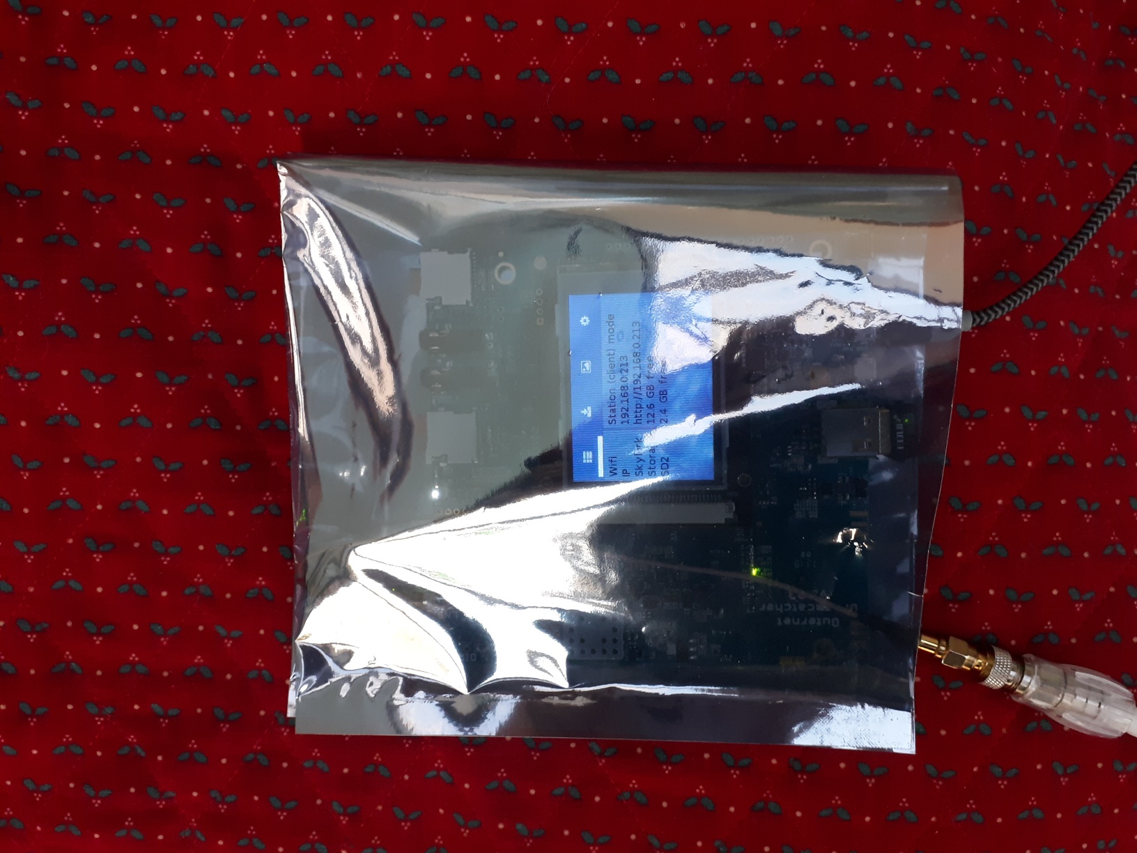

Even with good SNR and Rssi, my Valid packet % was down to 92 % from 100%, and my Bitrate (bps) was down from 20000 to 16624. Moving the Dreamcatcher 20 feet away was one solution, but to keep all my gear together I put the Dreamcatcher into its foil shipping bag - -
This improved performance back to optimum levels - -
If you don’t have the foil shipping bag, you can use a New York Style Bagel Crisps bag
which is foil lined - - I prefer the garlic variety :heart_eyes: Ken
Just to clear things up for everyone else:
at the present moment, the “correct” value for Packet rate is about 10.3, Bitrate is about 20200, and Audio bitrate is about 8100. If you see your reported values significantly lower than these you are losing packets. This is true even if the Packet Error Rate value is low/zero.
Packet Error Rate (or equivalentlym the Valid packets %) reports packets that were received by the radio, but failed integrity checks. It does NOT include packets which were not received by the radio at all.
For example, in the screenshot posted by @kenbarbi, his Tuner reports 8% packet error rate. But the reported packet rate is 8.57 which is about 20% lower than the nominal value. So whats happening is that his radio is entirely missing about 12% packets and then additionally 8% packets are failing integrity verification.
So its important to match the packet rate against expected value, just looking at the PER or Valid % is not enough.
