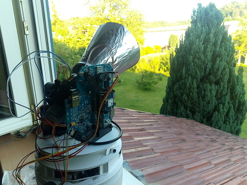

Another thing that I was thinking about recently is a gyroscopic auto aligner for the antenna, I have used something similar while working at university, we used a raspberry pi nano and a gyroscope that had a compass to firstly align with north, then cross reference the pitch of the antenna via a stepper motor to correctly focus on a satellite.
I think this could work if you had a database already in memory with relative satellite positions and earth (Longitude/Latitude) data. Again, I think this would also need a GPS for it to work correctly, so this is something to consider.

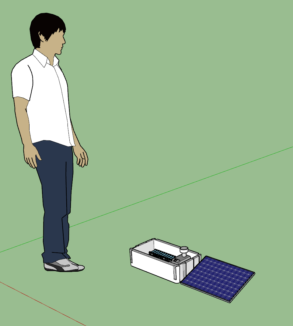

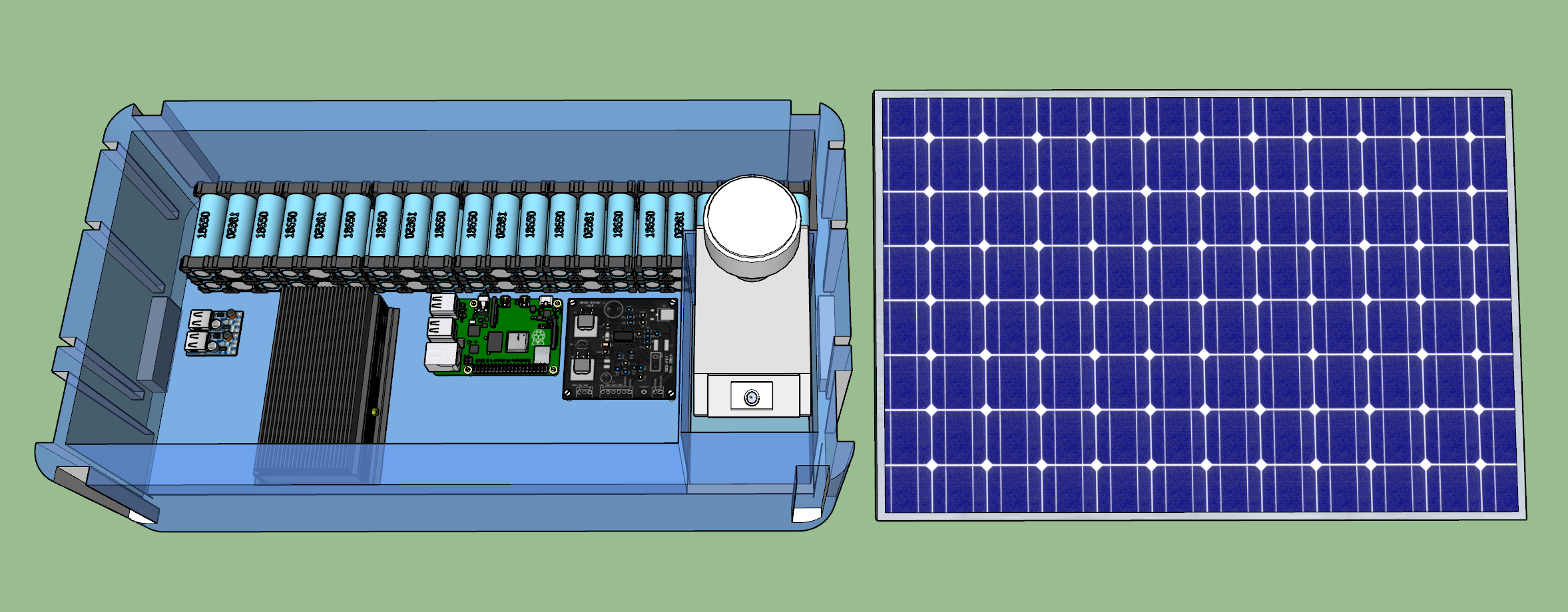

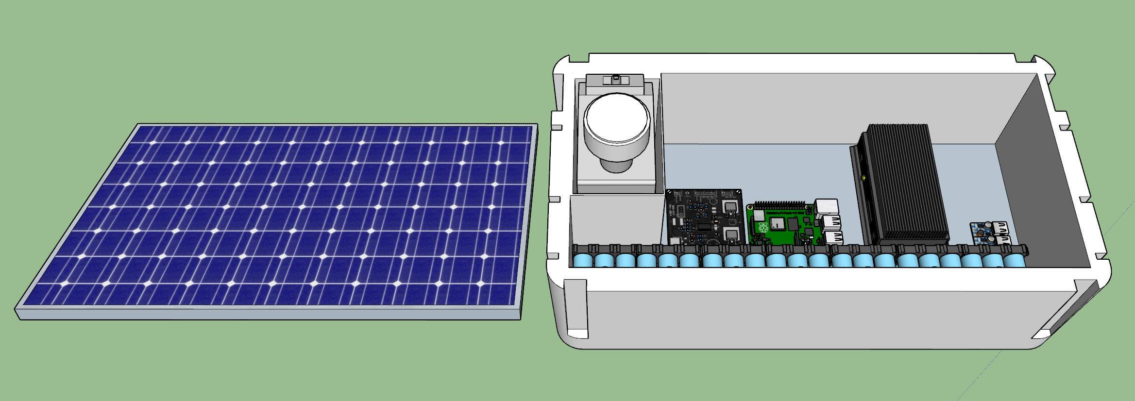

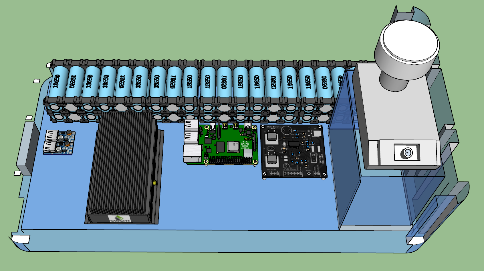

The size of the pelican style case would be as follows – Reference (iM2200 STORM CASE)
| Int. Length (mm) |
381 |
| Int. Width (mm) |
267 |
| Int. Depth (mm) |
152 |
| Int. Lid Depth (mm) |
51 |
| Ext. Length (mm) |
411 |
| Ext. Width (mm) |
322 |
| Ext. Depth (mm) |
168 |

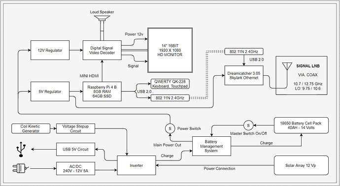

The battery is going to comprise of a 10Ah Battery made from 18650 cells running at 12v it will be connected to a BMS > Inverter (Solar Charging) > 5V step down to USB output.
1 = USB Power output (Predefined) – Raspberry Pi Computer
1 = USB Power output (Predefined) – Dreamcatcher v3.05
1 = 12v Power output ^ Inverter (Predefined) – laptop Screen Touch screen (Waterproof)
The Raspberry Pi computer will be used to interface with the Dreamcatcher device though a WI-FI module connected to the Raspberry Pi, the PI will then display the information of the skylark system to the monitor via HDMI.
Connected to the raspberry pi will be a USB keyboard mouse combo (similar to the old ThinkPad (nipple mouse) this will be covered in a rubber waterproof layer >
This will be used to interface with the Raspberry Pi computer. Running an OS (Android or Linux).
