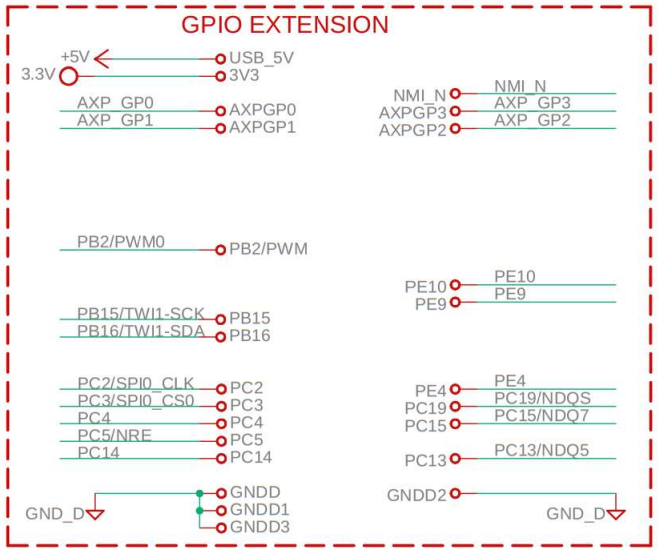

Can you do a direct link between the Dreamcatcher and the Pi ?
I looked at the schematic for the dreamcatcher, and I didnât see any I/O that indicated this?

Do you know where i can find the full schematics? for the dreamcatcher
You can replace the WiFi adapter on the dreamcatcher with an ethernet adapter and then use a crossover cable.
Or as Syed has already stated, you have access to the root of the dreamcatcher. You could do some sort of network re-route via the IO pins (I2C maybe?) into the RPi. The serial port should be capable of megabaud speeds?
I havenât released the full schematic.
