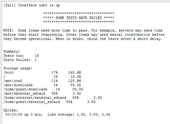

Here’s the System Status look at the 64GB SanDisk in the OS slot with an 88% filled 32GB FAT32 data card in Skylark 5.1:

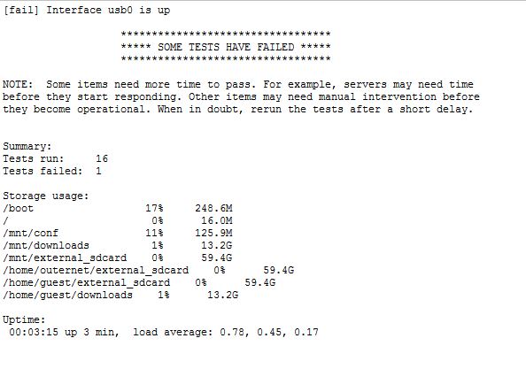

Here’s the System Status look at the 16GB SanDisk in the OS slot with a 1% filled 64 GB FAT32 data card in Skylark 5.1:

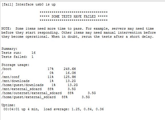

Here’s the System Status look at the 16GB SanDisk in the OS slot with an 88% filled 32GB FAT32 data card in Skylark 5.1:
