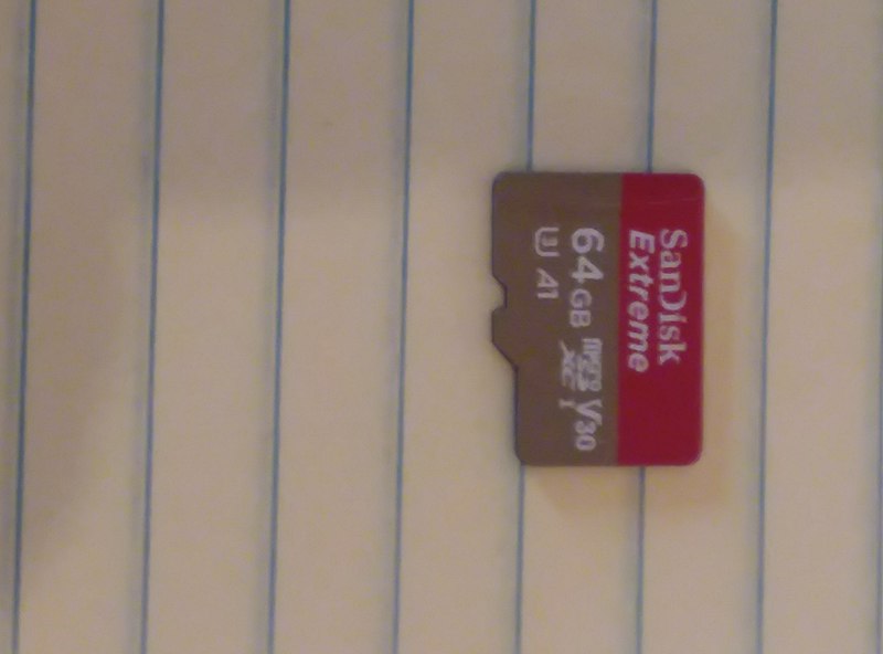

I bet your 64 GB SD card is an SDXC card, it may or may not be compatible with the DreamCatcher 3.02.
Because SDXC uses a different file system called exFAT and it works differently than standard SD cards, this new format is NOT backwards compatible with host devices that only take SD (128MB to 2GB) or host devices that only take SDHC (4GB to 32GB).
The hardware may not be able to that SDXC card.

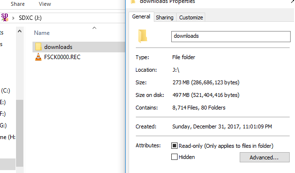

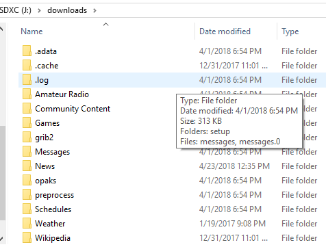

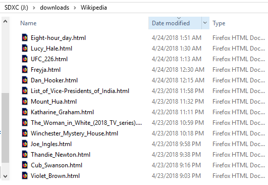

It works!
…and in both 32 GB halves of it? Grrreat. That means we might be able to store the entire Rachel package on the storage side of the DreamCatcher. I was not ready to D/L such a huge file and p…s off my ISP until I knew it could be done.
can you please check what the partition size is?
Will do when I get home. Had to pick a child up from afterschool sports. It was a brand new card from’Sam’s club. All I did was take it out of the package and put it in the DC.
ok. so atleast that means the DATA card (SD2) can be quite large. Might be worth testing the same card as the OS card (SD0).

The wife is in town, I will have her pick up another SD card from Sam’s. Here’s a pic of the card I am using if anyone else would like to try.
