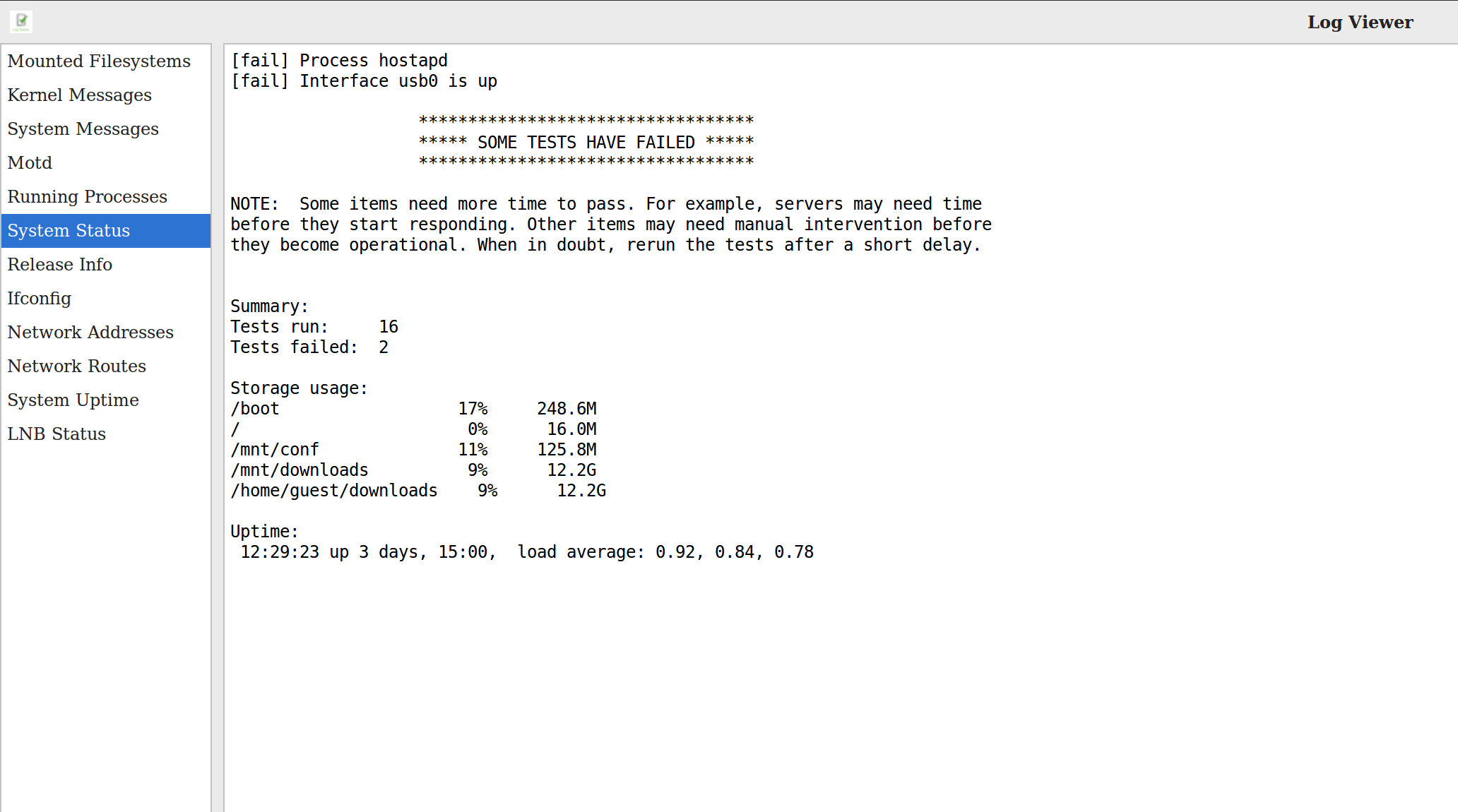

Installed Skylark on 64GB SD card. Rufus created 2 partitions 8MB, 300MB, and an unpartitioned 59.1GB section. Plugged it in and after a minute or two, the outernet AP showed up.
can you please report what that unpartitioned space turned into after skylark booted? I want to check if Skylark is using the entire available space or not.

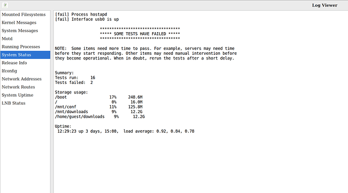

basically a snapshot like this:
Exactly. Now the only question about the 64 GB (and eventually the 128 GB) SDXC is can you actually fill or get past 32 GB of capacity. Just because you can partition it that way, does not mean you can actually get to the data.

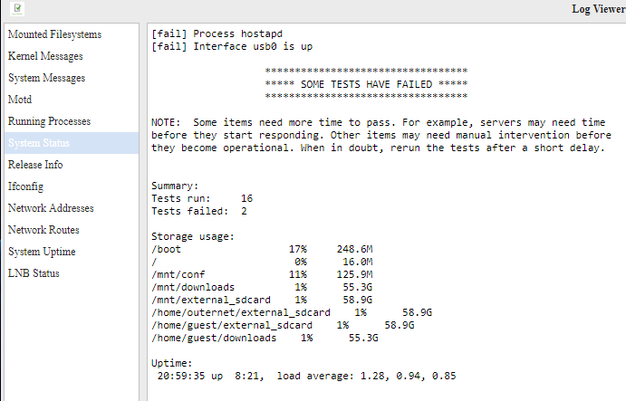

Good news, I think the instruction manual (@kenbarbi) should mention that an SDXC 64GB can be used in either sd slot. That means I can put the 64GB version of Rachel onto the data sd slot. (after I try and download it)
thanks! The OS is able to use the whole thing, AND the bootloader is able to deal with the larger card.

thanks! In both cases, it would be good to see the partition info as reported by the Log Viewer -> System Status, so we know that the entire card is being used and not just a smaller part of it.
