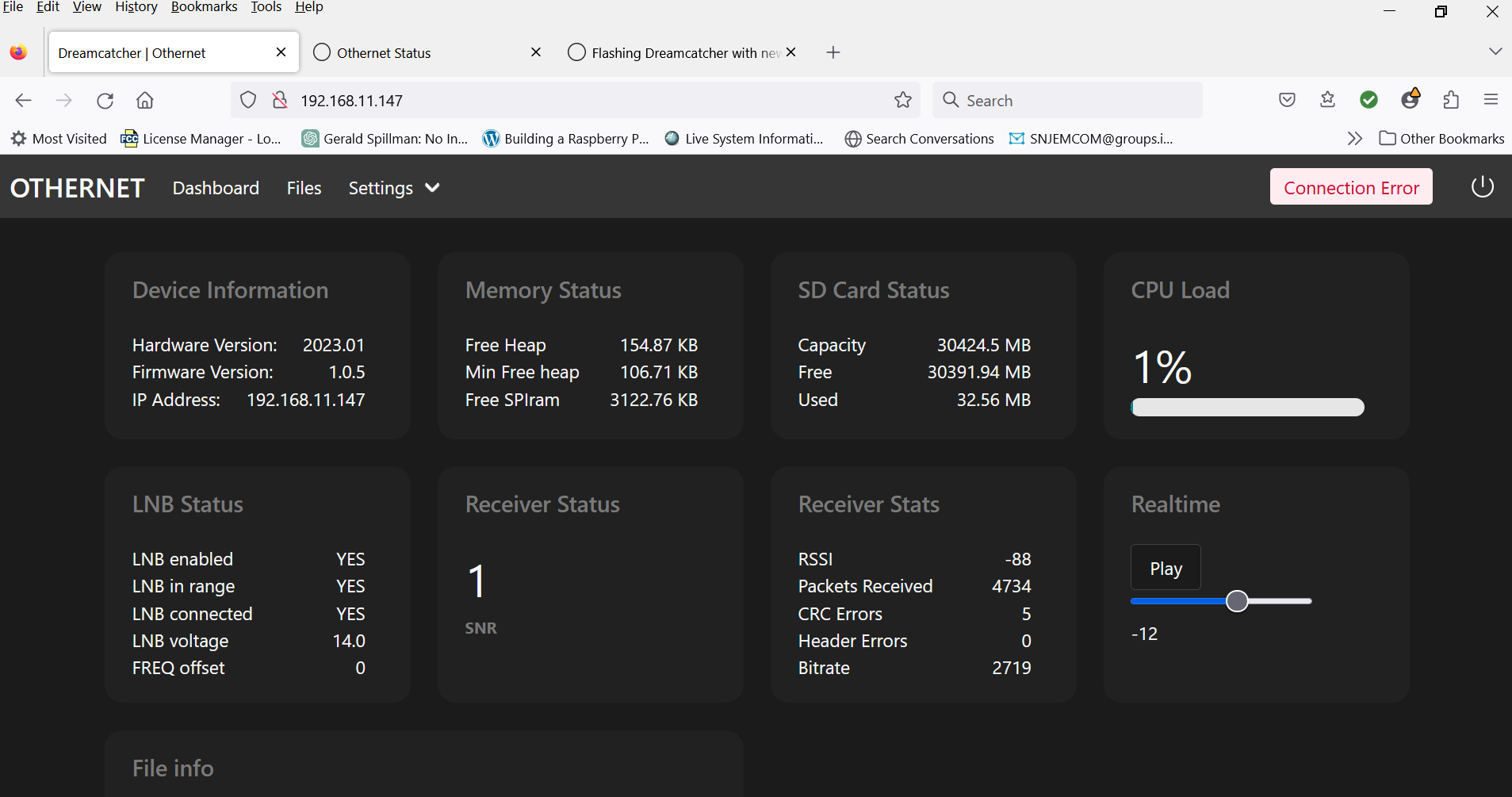

Interesting that this stall always occurs around the time the packet count gets just above 4700, isnât it?

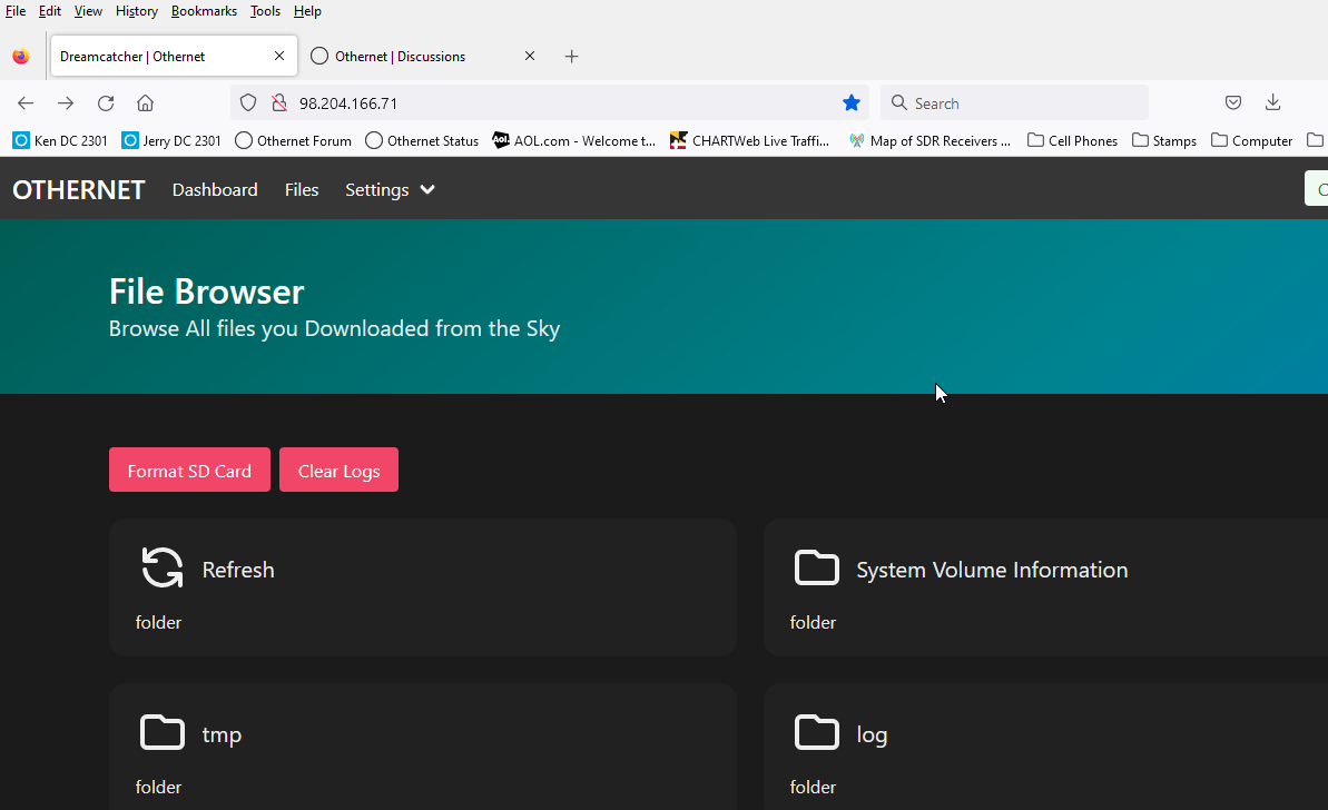

Clearing Logs
Donât forget - - everybody - - to clear the large Dreamcatcher Logs, go to this page and Clear Logs Ken -
Is it 4700 packets, or is that just roughly the number of packets transmitted in one hour?

1410 hrs. MDT 03-06-2023 Wifi stopped at 4680 packets downloaded. 44 minutes.
