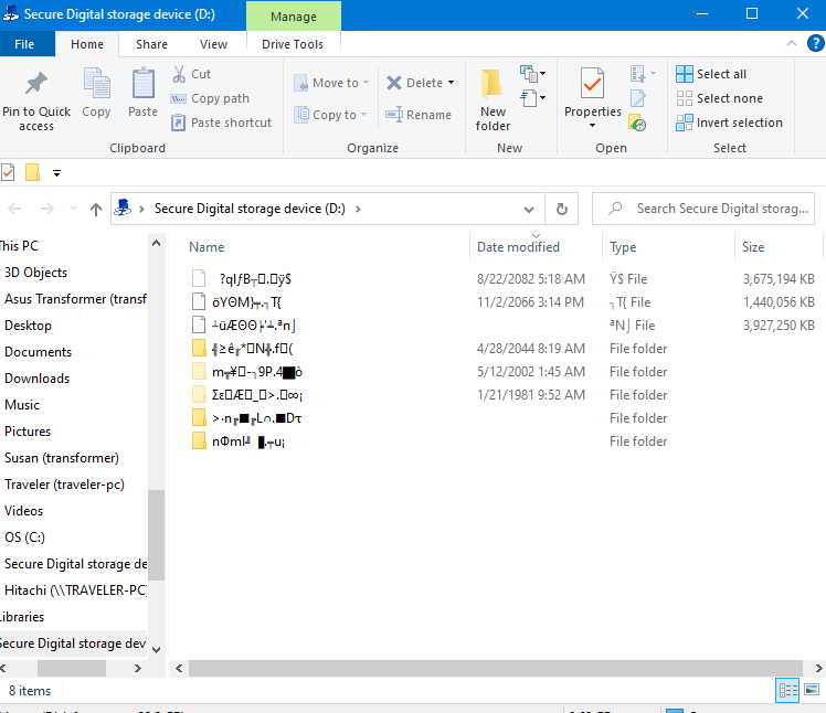

At this point, I can not see the DC at all even when connected to the Othernet Wifi. I have powered off my DC, and the lights are not right - solid green on one and NOT blinking on the other indicating downloads. I took the SD card out and it is corrupt - -

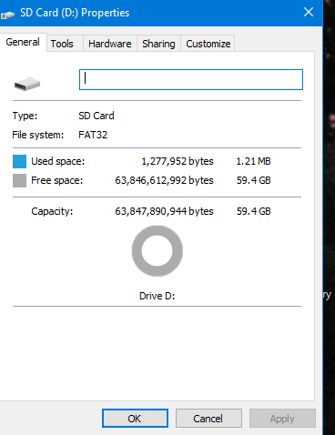

I can’t explain this, so I am reformatting my 64 GB micro SD card again as a FAT32, and restarting everything as soon as I get the SD card ready. Ken

Isn’t it’s max size 32 GB? @kenbarbi
Ah ha - - maybe that’s why Jerry and I are loosing connectivity. I’ll make the change and see what happens. Ken

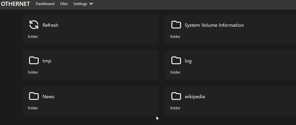

Jon, most of the files being received today are going into new folders in the Files Pull Down - -
into the News and Wikipedia folders like this for today’s news - -
When messages come down, a Messages Folder should be created. Yes it seems slow. Ken

SD Chip Size I used a 64 GB chip originally because that’s what worked fine in the old Dreamcatcher (DC) Series and had enough space for me to install a Rachel Database. Unfortunalely, I had problems with file corruption in the DC 2301. When I changed to a 32 GB SD chip, all worked fine. But tell us, what does too big an SD card do to the DC. Also, I forgot to ask, does the DC 2301 need an external data card? Based on current storage of what I’m seeing 20 MB of data per day, a 32 GB SD card will last for about 4.5 years before becoming full. Is there an automatic old data cleansing that is taking place in the background?

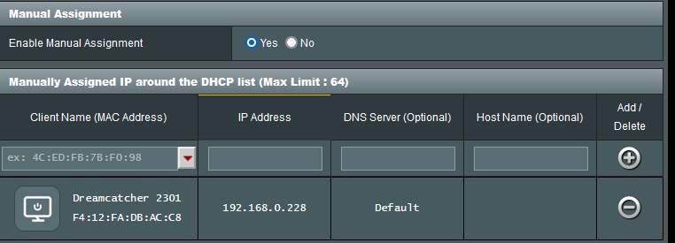

Lost of Wifi Connectivity Remember the old DC had issues when reconnecting to a router after a power failure (the DC came back sooner than the router and couldn’t get an address - - so became dead in the water). Is it possible Jerry has an IP reassignment issue when the DC periodically reboots? I locked my routers IP assignment to the DC making it manually assigned rather than thru the router DHCP protocol’s automatic IP assignment function. Ken

The reason for the 32GB size limit is because the firmware uses the FAT32 file system. FAT32 has some limitations. I could be wrong, but I assumed that SD cards larger than 32GB would cause problems because they use exFAT. Sticking to 32GB SD cards with FAT32 seemed like the safest option.

This unit is mounted in the same place as my old 3.05 was, same wifi environment. It has, like Ken’s, an assigned address on the home system.
