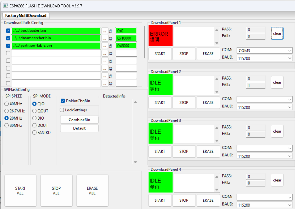

@Syed - I’m excited to get started with my 2301! However, while trying to flash the latest firmware, I keep getting an ERROR in the MultiDownload application. The log reads as follows:
[2024-07-11 16:34:04,700][ESP8266Loader_multi[1]][espDownloader.py][line:770][ERROR]: ESP8266 Chip sync error esp_sync_blocking.
no log file output …
test offset : 0 0x0
case ok
test offset : 65536 0x10000
case ok
test offset : 32768 0x8000
case ok
I have tried two different SD cards, two different cables, and storing the .bin files in multiple locations. I read on another forum that the board may need a reset pin jumper set, but that was not for the Dreamcatcher board. Any suggestions?

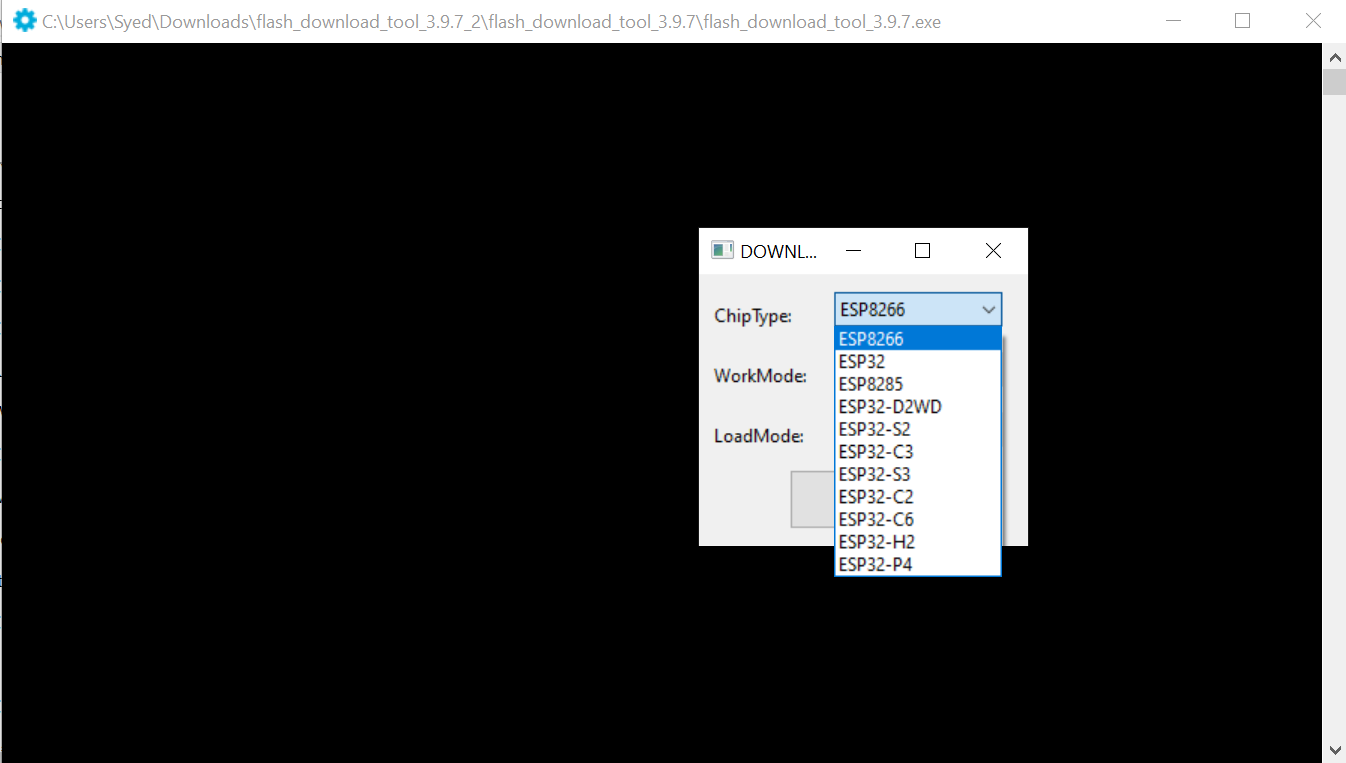

Hello! I think your setting may be wrong. We don’t use an ESP8266. The module is an ESP32-S3.

I see. The link provided to the Espressif Flash Download Tool is for the “ESP8266 FLASH DOWNLOAD TOOL V3.97” as is linked here:
The instructions with that link are as follows:
Here are the instructions for updating the firmware on your ESP32-based Dreamcatcher.
  1. Connect your Dreamcatcher to your PC with a USB-C data cable.
  2. Download the Espressif Flash Download Tool . This tool requires Windows.
  3. Download the three files necessary for flashing from Github. Remember the location of these files.
I think this is where the ESP8266 reference comes from. I don’t see anywhere in the tool that allows me to specify ESP32-S3. I’ve tried two other ESP flash tools and neither will communicate with my Dreamcatcher. I’m 90% sure this is something I am doing wrong, but 10% wondering if the board has an issue.
I see that the screenshoit posted last year by maxboysdad shows the tool as ESP32S3, but as you can see in the screen shot here it is now a different tool.
When you start flash_download_tool_3.9.7.exe, please select ESP32-S3 from the drop-down menu.
I still use the 3.9.4 version of the flashing tool. Hopefully there is no issue with the latest version (3.9.7).
It worked! Thank you so much for your expert and rapid response.
