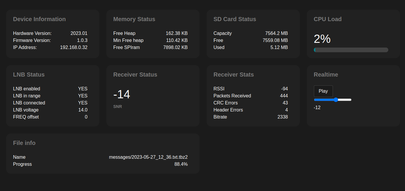

Printed some brackets to hold it (pringles can, shape files are on the forum some where, and out on thingiverse) to replace my solo cup lined with foil stuck over the top of the LNB…
It just finished and the solo cup wrapped in foil actually did better than the Pringles can… (but the brackets hold the solo cup better too, so calling it a win…) might get the tin snips out and try to cut some metal flashing into a cone later this weekend… I’m headed out of the city later today so I might set it up for a bit and see if just less noise helps… long term plan is to use it when camping to get the weather so I might not need as much outside of the metro…
How much SNR improvement did you get from the solo cup?
Hard to say, it went from nothing to something when I put it on.
Between -14 and -12 with the cup, was getting -17 to -15 with the Pringles can (and only crc errors).
Wow, that’s definitely something. I imagine a solo cup with metallic vapor deposition would produce even better results. If nothing it could be something to include in the kit.

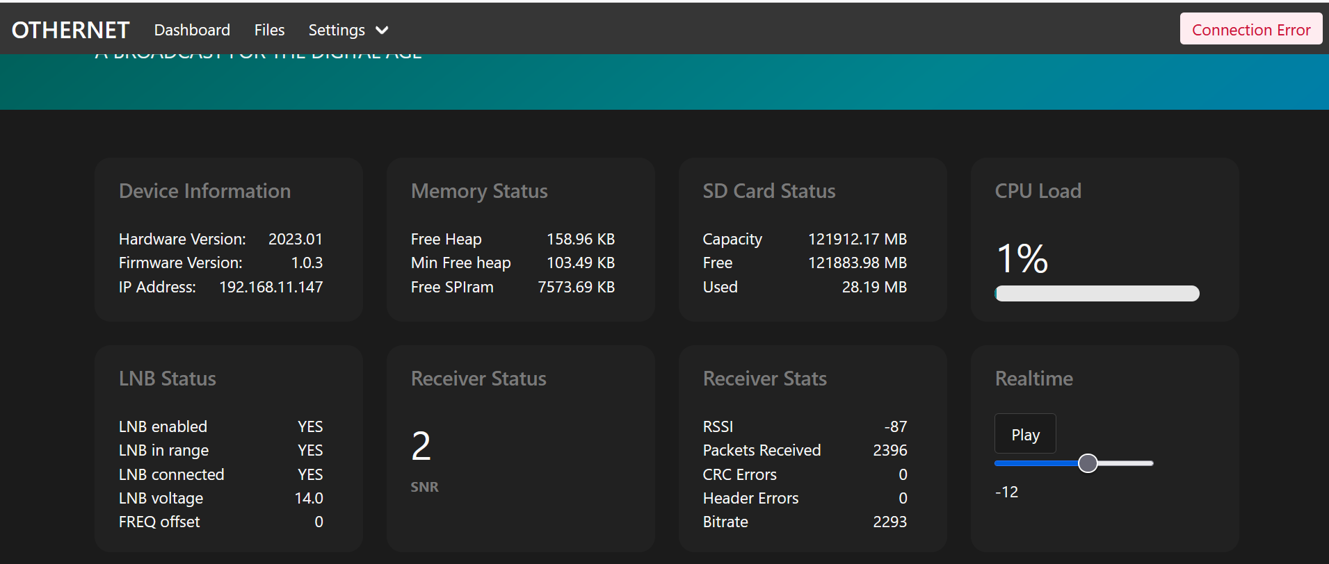

Top right corner of the Dashboard screen, where it normally would say ā€œConnectedā€, it shows ā€œConnection Errorsā€ and the unit is disconnected from the wifi, and occasionally needs the receiver frequency to be saved also when this occurs. It does not stay connected for very long.
This particular connection lasted about ten minutes.
@maxboysdad Could you please post your logs?
It is pretty large, do you really want it on this page?
Are you able to post it as an attachment?

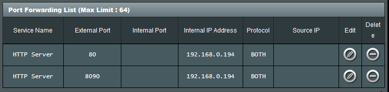

My Dreamcatcher 2301 is now port forwarded (as both External Port 80 and 8090), and can be seen at http://98.204.166.71/ and http://kenothernet.duckdns.org/
It is located outside of Washiington, DC, in Annapolis, MD. I see it on the Othernet Status Dashboard. All appears to working fine. Ken
I guess I don’t know quite how to do that. I can access the log file, but not seem to know how to get it from the 2301 as a file. I can copy it to the clipboard, and then deal with it as an ordinary text file, but it is pretty large (352 K)
I just got my port forwarding working, you can access it at: aeroute.ddns.net, I just got it connected, and the forwarding is working.
@maxboysdad @kenbarbi Thanks. I’m reviewing it now. I hope these Dreamcatchers are on separate wifi networks (separate from your home network)? I am concerned that the device could be easily taken over and then act as an entry point into your home network.
Mine have always been on my home network.
I have two Routers - - the first (which does my port forwarding) only has Othernet, YouTube, etc. And my Fire Walled Home Network with VPN and a PiHole handling everything else.
Do you think that will be OK? Ken
@kenbarbi I’m no network security specialist. I would err on the side of caution and simply remove the device.
@maxboysdad I don’t think exposing this device to the internet and also putting it inside of your home network is safe. I strongly advise against this.

I appreciate your concern here. Also, the assistance with the 2301. Did the logs reveal any reason or possibilities of why I can’t stay connected? No other devices on the network are experiencing this problem, nor did the old 3. series DCs.
Jerry and I just realized that connecting to the Dreamcatcher (DC) is automatic without any password protection like the old Skylark login. So under these circumstances, anyone can get into our DCs and make changes etc. Is that true? Ken
Yes, that’s correct.
