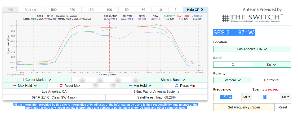

Just correct it, thanks. It’s 11902.4 MHz
@donde I’m not sure an LNA would be useful without the tighter beam width of a higher gain antenna. The issue is not lack of energy being received, it’s co-channel interference.
@Diggity We are focusing on the coverage area that gets about 49 dBW, so if you can fabricate a way to increase SNR, you should be ok.
@Diggity Since you are so far out, I would suggest not getting a Dreamcatcher.
Gosh, glad you told us! I would have been looking for the needle in the wrong haystack.
New SDR frequency: 1152.4 Mhz (for a 10750 IF LNBF)
Oh you know I wanna play with it. Let the high-SNR games resume!
Here is an L-Band look at the Outernet signal …
