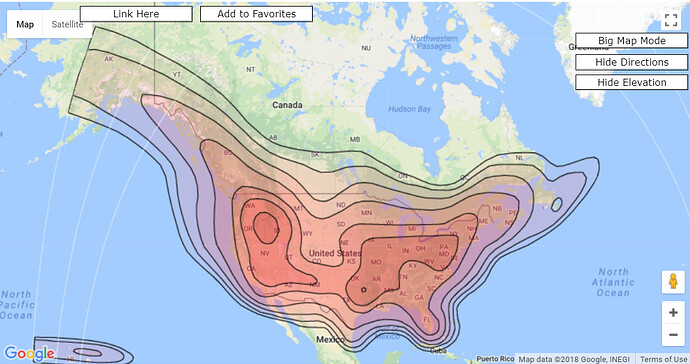

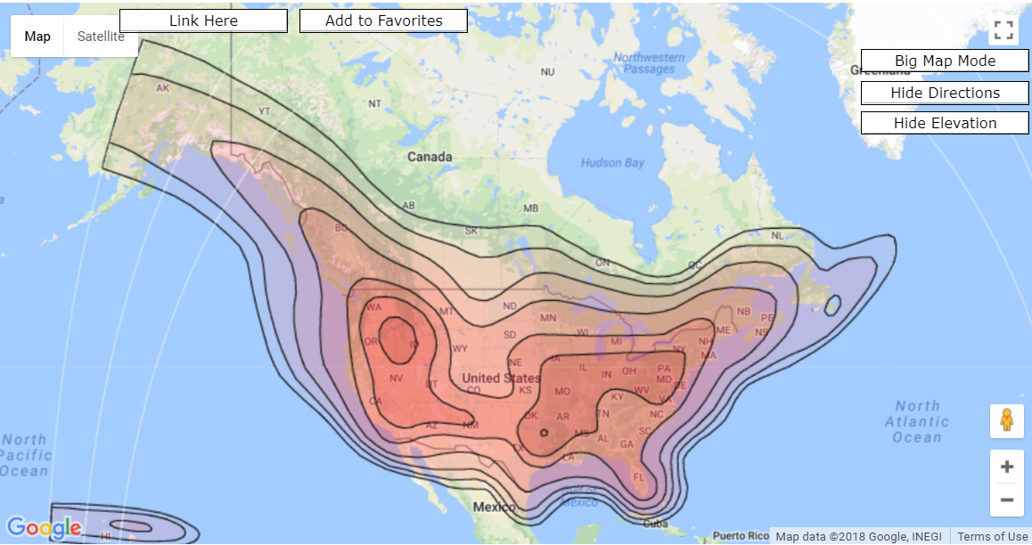

I think the map you posted was not correct. Purple indicates C-band. Red is for Ku. This is the coverage map for SES-2 Ku NA.

OK … I now understand what you meant by map. Yes, the coverage map.

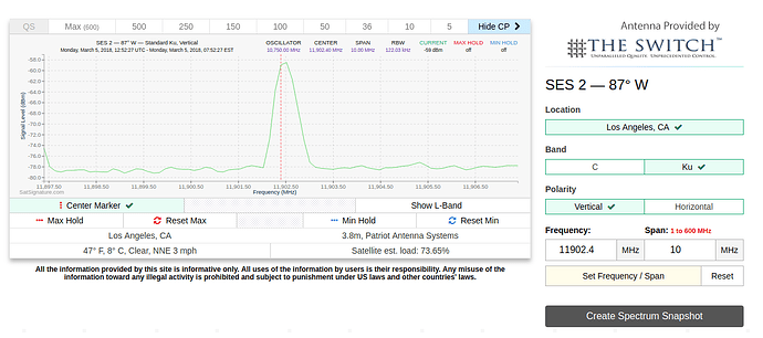

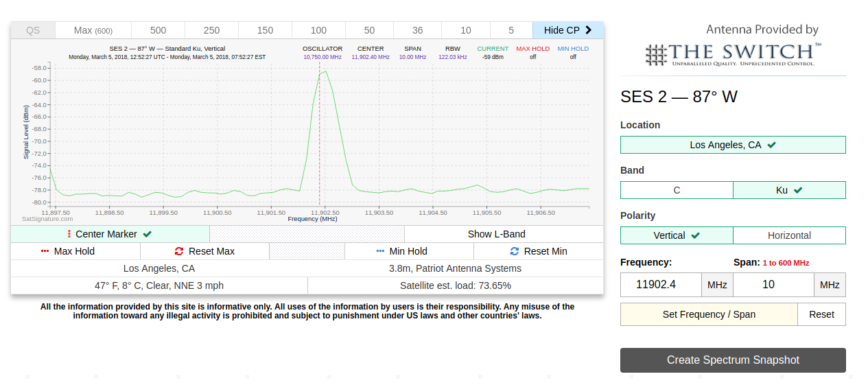

The Outernet signal is below noise level without a dish and just an RTL-SDR. You may need a dish to “pull it out of the weeds”. With a spectrum analyzer and a low enough resolution bandwidth, you can see it.
In fact, you can definitely see it here: Outernet signal on SatSignature.com
