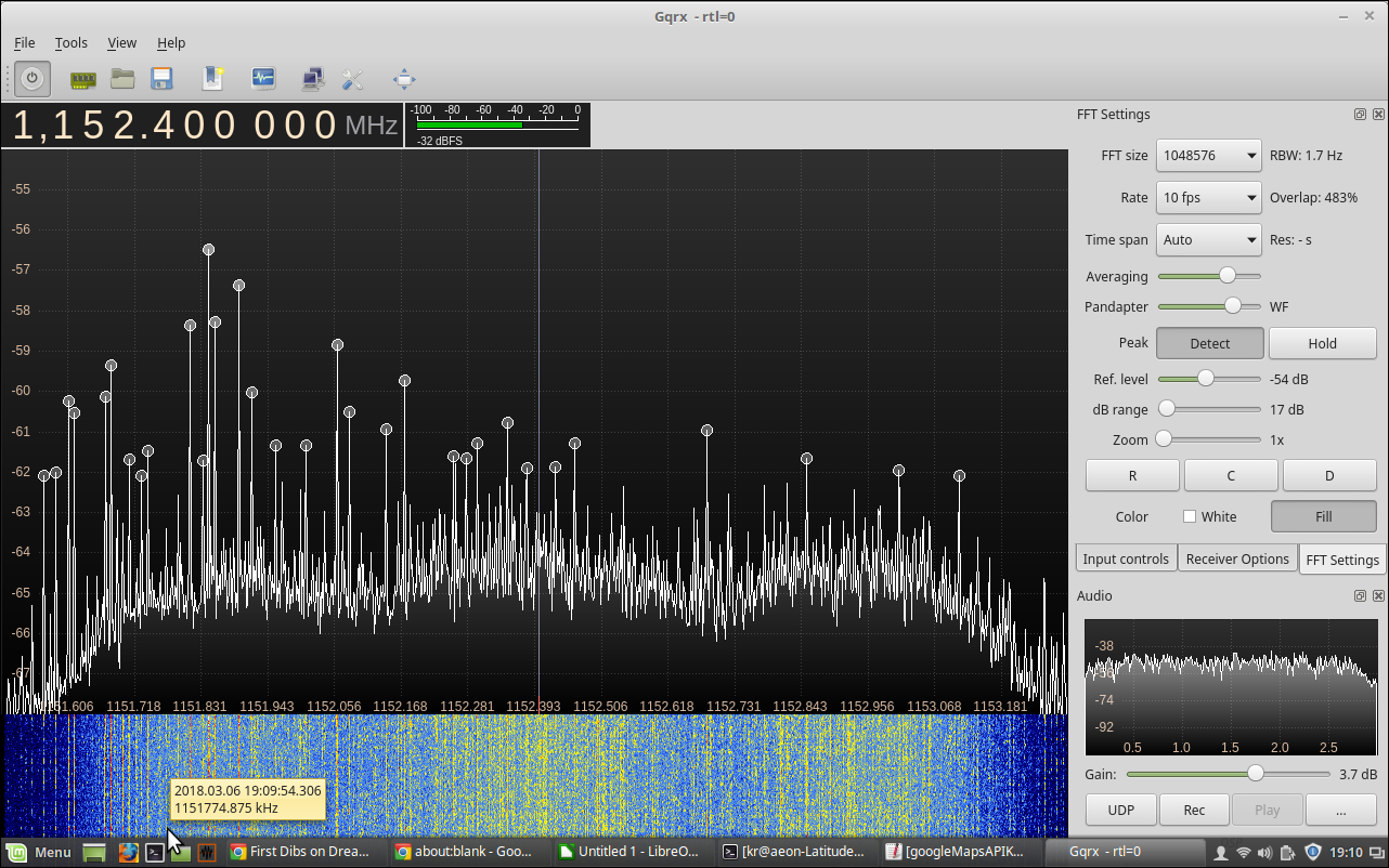

I like the satsignature.com spectrum using the 1152.4 mhz from SES-2 showing -66 dbm,
however that is a 3.8 m antenna.
If use a calculator like Parabolic Reflector Antenna Gain Calculator - everything RF
and assume a k eff of 65% at 11.9 GHz then it is providing 51.6 dB gain.
So without the dish we would get -66dbm - 51.6 db or -117.6 dbm (I think simple math works with db units)
that is well below the receiver sensitivity of the sx1280 LoRa using spread factor 7. Unless my math is way off
 I don’t see how this works. Except for the extreme SF like 12.
The LNB has gain over isotropic, about 12 dB or so on its own.
So you need to meet sensitivity plus a bit of margin – 6dB?
So I think in LA they will see -111 dBm with plenty of margin.
SF9?

I believe this is the Outernet signal received with a bare Maverick MK1-PLL, at 1152.4 Mhz (for a 10750 IF LNBF) on SES-2, with a bias tee and a NooElec RTL-SDR dongle. I’m using GQRX on a Linux laptop. All I see is noise. With a dish, I might be able to see something.
