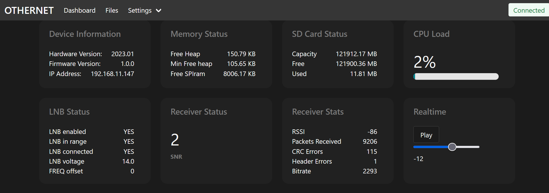

To continue my log here, it is four hours after I last checked in here, the wifi is disconnected. I had to go to the url, hit enter, then go to receiver and save to get it running again. SNR = 2 and 1, RSSI = -87

YES, it is assigned a static address on my system. I had to power it off, back on, then go to the url, it connected, then had to save the receiver frequency. It then started up and is acting normally (this only in last five minutes). I didn’t think to look for the ssid before I rebooted it. Perhaps next time.
