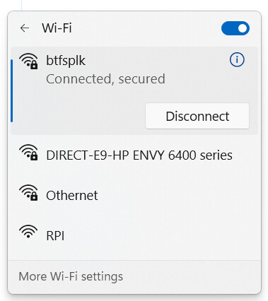

Opening the Wifi Client screen does not show the SSID of my network, but shows an SSID of “myWifi”, as though there was no change recorded (unlike previous iterations of DreamCatchers).
Opening the Wifi AP screen shows the SSID of “Othernet DC4”. As is shown by the screen shot above, it is still advertising the AP “Othernet”, even though a static address is assigned from my network. And if the unit is re-started, it will temporarily revert and connect, and when the receiver frequency is saved, it will work as a client for a short time, then goes to “Connection Error”, and has to be re-connected or rebooted to resume reception.
In both screens, these items are both greyed out in the selection boxes, even though the assigned URL does show on the dashboard as shown on the screenshot above.
The appearance is that this unit is trying to be both a Client and an Access Point at the same time, and not switching over to being a full-time client once that choice is populated by the operator.

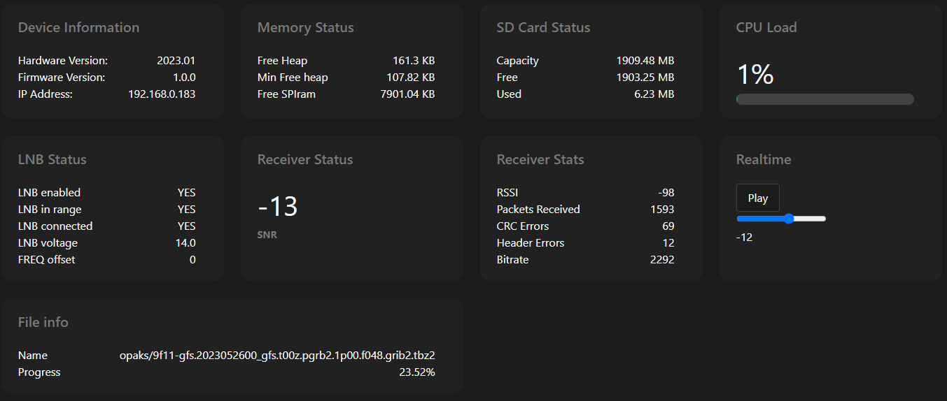

Can you please show a screenshot of the hardware and firmware version?
Hi Syed, please see the device information below.
Ok, let’s start with new firmware first. I’m posting something in the next 30 minutes.
