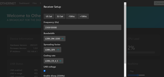

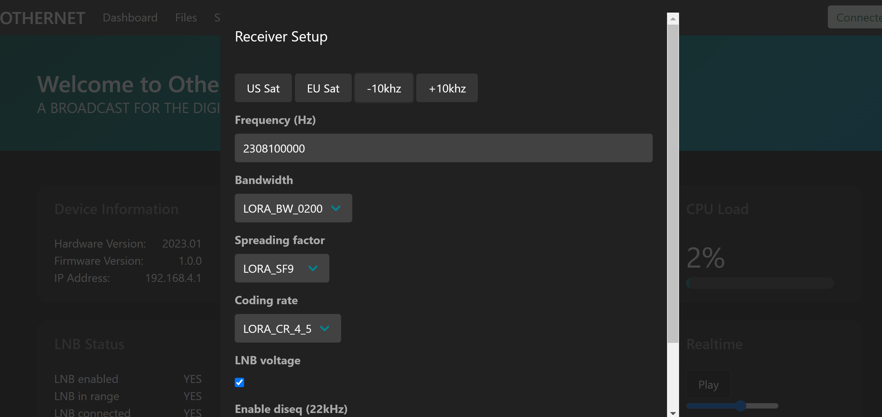

I just fired up my 2301 (replacing my 2206). No changes to LNB / aim (Bullseye mounted on Dish Network). I was getting about SNR about 1 before the changeout. I clicked the new “US Sat” button (I am in U.S.) but I got a different frequency 1308100000 instead of 2308100000. @SYED post from May 14 said 2308100000 and that’s what I had on the 2206. Is the 2301 different? Here’s a screen shot:
@BillMc There is a typo/bug in the latest firmware. The US setting should be 2308100000. The incorrect value that shows is 1308100000. Please manually change it to the correct value.
