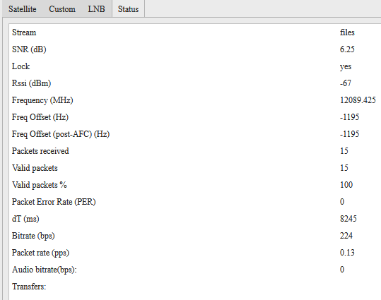

I can definitely see the slower packet rate. This is after I changed the beam type.

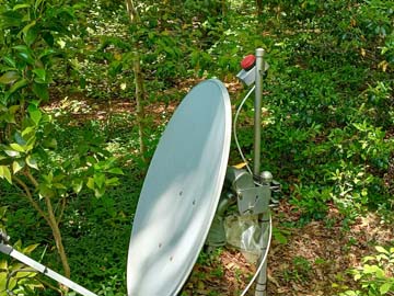

I changed my configuration just now to Beam type 55 on SES-2 and am up on the air with my 80 cm dish. So far no downloads are coming in. I’ll reconfigure with just a bare Bullyseye and get you a report. Ken

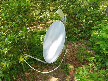

Here’s my Status screen with bare Bullseye - -
with this LNB setup Ken

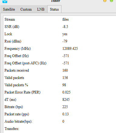

Here’s Status screen again for the bare LNB just sent -

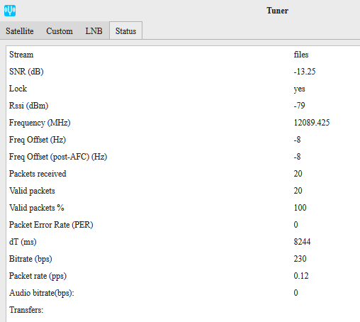

Here’s the same set up with aluminum horn - -

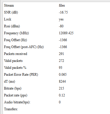

Here you go - - no horn - - I can take the beam aim from optimum for my location of 207 deg Mag to 189 to 225 deg (plus or minus 18 degrees) and still have lock in that range as shown here but a bit more and SNR drops below -20 dB - - this screen shot is right before SNR goes South at 189 degrees. At that point, I get SNRs below -20 dB and no lock, but still have respectable Rssi levels. Ken
PS - - The Packet Errors are an accumulation of my LNB movements, If I reset my DC after each LNB move, I’d get 100% each time, but didn’t do that here for my pictures.
