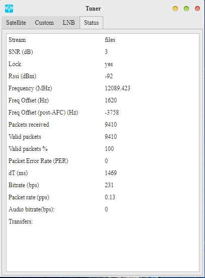

Not able to test with the bare LNB at this time but here are the results with an 18-inch DirectTV dish, Bullseye LNB, beam type 55.
