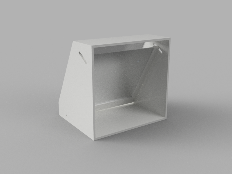

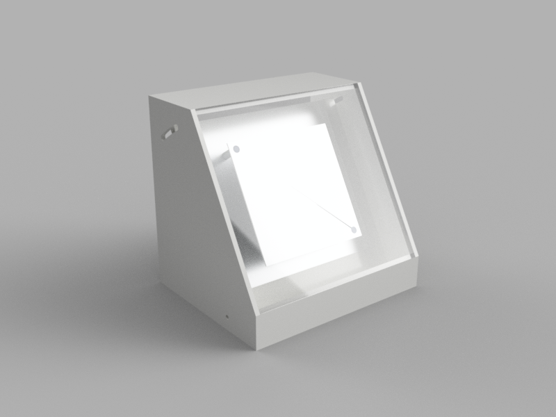

Iāam planning and designing a 3D printable case for the DIY Kit in the moment, that will be published on thingiverse when it is completed.
You will be able to addjust the angle of the Antenna between 25°-35° (this range because i need ~30°). Because of that, it will not be useable for everyone in the world, but it should be fine in central europe, i think.
The only thing that i need to add to my current model are the brackets/mounts for the other components (CHIP, SDR, LNA) and a hole for the microUSB port. All of this will be mounted on the backside of the case, that needs to be designed to.
Iām also planning to engrave the front acrylic glass and adding some LEDs in the future.
The case itself will be printed in PETG so it doesent melt in the sun ![]()
Here are some renders:

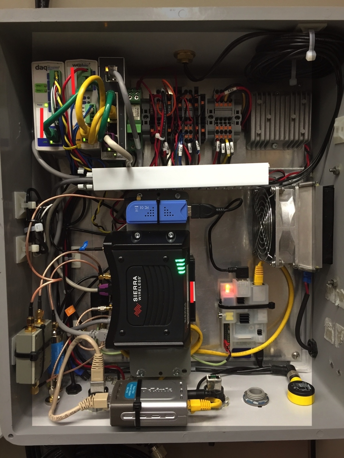

It is a solid state cooled enclosure that houses two ADS-B receivers. It has automatic temperature control and remote access. 48, 24 and 5v power. Just for fun.

To a great extent, yes, however, if the heat load in the box is sufficient, it is a self healing environment. One of my boxes, pictured above, runs 24/7 with no desiccant pack at all. It has a lot of gear inside, and for example, today, with 73F external temp, the inside is 80F. The internal fan runs all the time. No condensation, because there are no ācold spotsā. The fan keeps the cooling fins dry.
Either you have the power wired up backwards to your cooler, or your inside and outside are backwards.
-C
Or your understanding of thermoelectric coolers, enclosures, and implementation is backwards.
The design is not to create a meat locker, but to efficiently move heat from a closed environment to the outside of the sealed enclosure.
