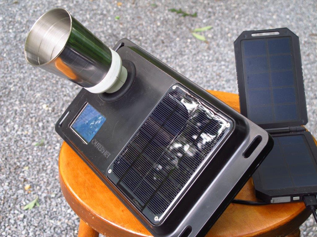

Latest Portable Ku Band Lantern with Dreamctcher v3.03/Skylark 5.2
Hereās my latest packaging for a portable Ku Band Dreamcatcher Lantern . . .
I extended the Touch Screen from the DC board with a short extension cable and surface mounted it so I could access and use it.
I crafted an expandable cone (2" x 3" x 5") that slips over the LNB and collapses when not in use. It is a large stainless steel drinking cup with the bottom cut out. This configuration gives about a 2 dB SNR improvement as opposed to my 2" x 4" x 8" horn which gives a 4 dB improvement.
My thinking is a larger (longer with a larger top diameter) collapsible cup is required. I am running the Lantern from a solar charging battery pack. Ken
Ken, youāre amazing! Tell us about the solar charging pack.
I got the solar charging pack a couple of years ago back in the RaspberryPi days. It is 6,000 mAh portable charger with flip out solar cells. Figure how long that would run a Dramcatcher (DC) - - not very long.
It takes almost 10 hours of direct sun light to recharge it from dead, or you can plug it into a power cube for a faster charge. The down side of this unit (unlike the EasyAcc 20,000 which runs the DC and recharges; and acts as an uninterruptible power source during ac outages) is you canāt run the DC and charge the solar power pack from a power cube because the DC expends energy faster than the solar power pack charges.
Iāve seen other similar solar power packs in outdoor stores, but havenāt explored them. I use my solar power pack now when I travel for short duration operation of my DC. Ken

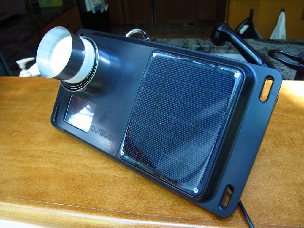

Several folks asked what the DC looked like with the cone collapsed. Here it is - -
I connected the bottom ring to the top of the LNB rather than sliding over and down to the case because it held better. If @Syed (and his team) come up with a better machined solution for a collapsible cone, it should be more conformal. Ken
