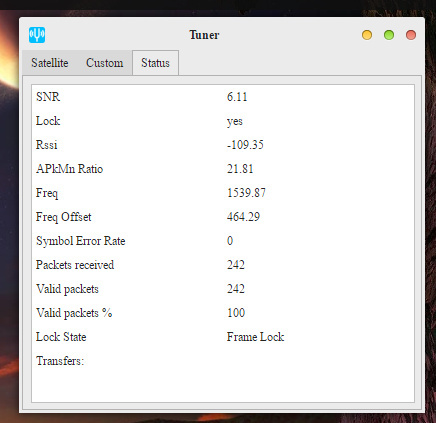

Again, I keep getting “Your receiver doesn’t seem to have reported in. Err: null” when attempting to access my.outernet.is. Rebooting again with the SDR connected allows me into Skylark (like the new look and feel).
When I go to the receiver section to make sure that I am getting connected properly with the sat, I get noise data for about 30 seconds and then it just quits altogether.

This is what is happening to me. It acquires, begins downloading and then stops a couple hundred packets in. I’ve been at this packet level for about 5 mins. now.

sorry - thats a known bug. You should quickly browse this topic from the top to see couple of other ones as well. Its fixed now (for the next release)
Your receiver is working fine - the tuner status has a bug in that it randomly stops updating the status report. It will also randomly start updating a while later (and repeat). If you want to check the actual status, ssh into the CHIP and run the “sdr” command. follow instructions the command shows you!
Other way is to just leave it be. You have good signal - just wait for the files to come down. A new message file should come down every 5-10 minutes, thus letting you know all is well.
