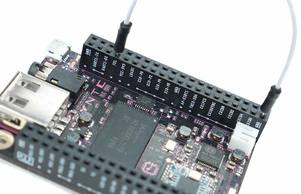

The new release brings with it enough changes that there is no way to upgrade to it using the .pkg updates. So flashing over USB is the only way to move to it. I have also created a new flasher based on VMs, which should be usable on windows, linux and macOS. (The new flasher would also of course need to be tested). You would still need a FEL header to connect the CHIP FEL pin - but no futzing around with usb
drivers, chip-tools, linux command line etc. All you need is to install VirtualBox and VirtualBox extension pack.

The FEL pin is on the CHIP. You short it to ground to kick it into flash mode. Just like the picture above shows. You would use the browser based flashing tool from the chip website.

As NTC has not made their chrome-flasher open, we can’t use that to flash, so I have instead built a Virtual Machine-based flasher. I will be distributing it as an OVA file that can be imported into most virtualization software - VirtualBox, VMware, Parellels, etc. Though Virtualbox is the only supported one.
So the process would be:
Install VirtualBox on your desktop Linux/Windows/macOS machine.
Install Virtualbox Extension Pack.
Import the .OVA file I give you by simply double-clicking it.
Powerdown the CHIP, and remove the radio from its USB port.
Connect the CHIP (with the FEL header connected) to your linux/windows/macOS machine(same as in 1 above) via the microusb port.
If the CHIP powers up automatically, thats great. If not, press the button on the CHIP to power it up.
Start the Flasher VM from the Virtualbox UI.
At this point the Flasher VM should detect the FEL-enabled CHIP and start flashing it. It will take about 2 minutes. The the CHIP will continue to boot and first boot after a flash can take another 2-3 minutes. Once done, its LED will start blinking. Do not power down / disconnect until this LED has started blinking. It is safe to remove the FEL header at this point too.
Note that this method of flashing erases all files from the CHIP internal storage, including your old downloads!
