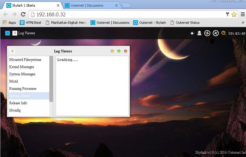

Still having issues here. Same as before - - Lantern goes into API calls when checking Tuner Status, and when I try to recover system logs - - I get no logs and plenty of new API calls
Any progress resolving this issue? I’m leaving this CHIP alone now (rather than reflashing it which is the only way I’ve been able to bring it back), and going back to my original CHIP also flashed to Skylark to see how it performs. Ken

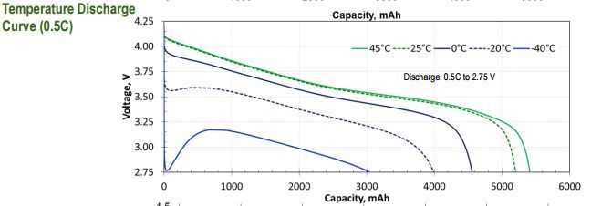

Second the Temperature discharge curves show lower voltages as temperatures drop below 0 deg C. Since the CHIP powers down at 3.35 vdc (which I believe was discussed several months ago when the Alpha Lantern was delivered to a few of us), in cold weather (and here in DC is is in the high 20’s low 30’s), we are very close to the border of operation/shut down.
If the CHIP shuts down at 3.35 vdc based on the battery level seen at the battery plug in port, even if the USB charger is plugged in and charging, the system can’t run. What do you think of this scenerio @Syed@Abhishek ? Ken
