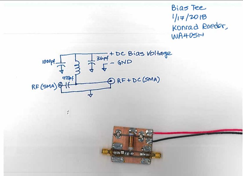

Here is my bias tee and schematic:
Surface-mount parts are really not that hard to work with. I took a small piece of two-sided FR4 circuit board and carved out the needed lines with an exacto knife. The back is solid copper. I ground the back with bare wire that connect front to back.
Looks good,
What’s the inductance of the coil?
73
Jason
KB2SDR
@Jason,
You caught me! (seriously, it was an omission on my part). I took a 100K Ohm resistor and wound some magnet wire on it that was in the junk box 30 ga? about 20 turns. I did not measure it. Typical values are around 1 nH. I don’t think it matters a whole lot.
I put it on a VNA and looked at the 21 (through) and 12 (reflected) and it looked ok. At VHF, UHF, and L-Band.

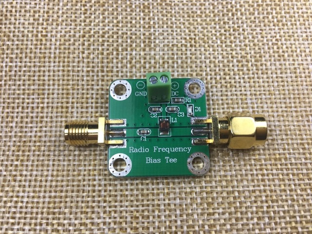

This Chinese one uses a tiny surface mount inductor L1 C1, C2 and C3 are similar. D1 looks like it’s for reverse voltage protection. It shorts out your power supply instead reverse-powering your LNA or LNB. I suppose R1 is a bleed-off resistor? Nice screw-on connector. The whole thing costs less than the SMA connectors on my board.
The point is that you can throw something together out of things in your junk box. I work with 1208 Surface Mount Devices because I can still see them and solder them onto home made boards by hand. I bought a grab bag of SMD devices for $5 at my friendly electronic store – Vetco
