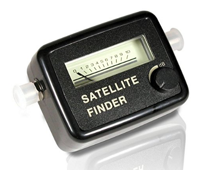

Do you know if a satellite finder with an analog scale and beeper will work on the DC-3.0? I may need to mount the LNB away from where my DC-3.0 card will be.
I’m not sure. As there is some DC that would be going through the finder, it should work. But we have not tested this.

These SatFinders are powered by the DC bias to the LNB and detect the signal level of the down-converted signal. The problem is that this device does not identify the satellite(s) it sees, only reports a signal level.

That type of ‘satellite finder’ is not very good. I bought one for 4 euros to lend to people who ask to borrow my expensive meter which I don’t lend out … If the satellite has a lot of TV transponders on it, it may help - but it does not indicate what satellite you are looking at so without a conventional satellite receiver AND Free to air channels on the target satellite you are working in the dark.
