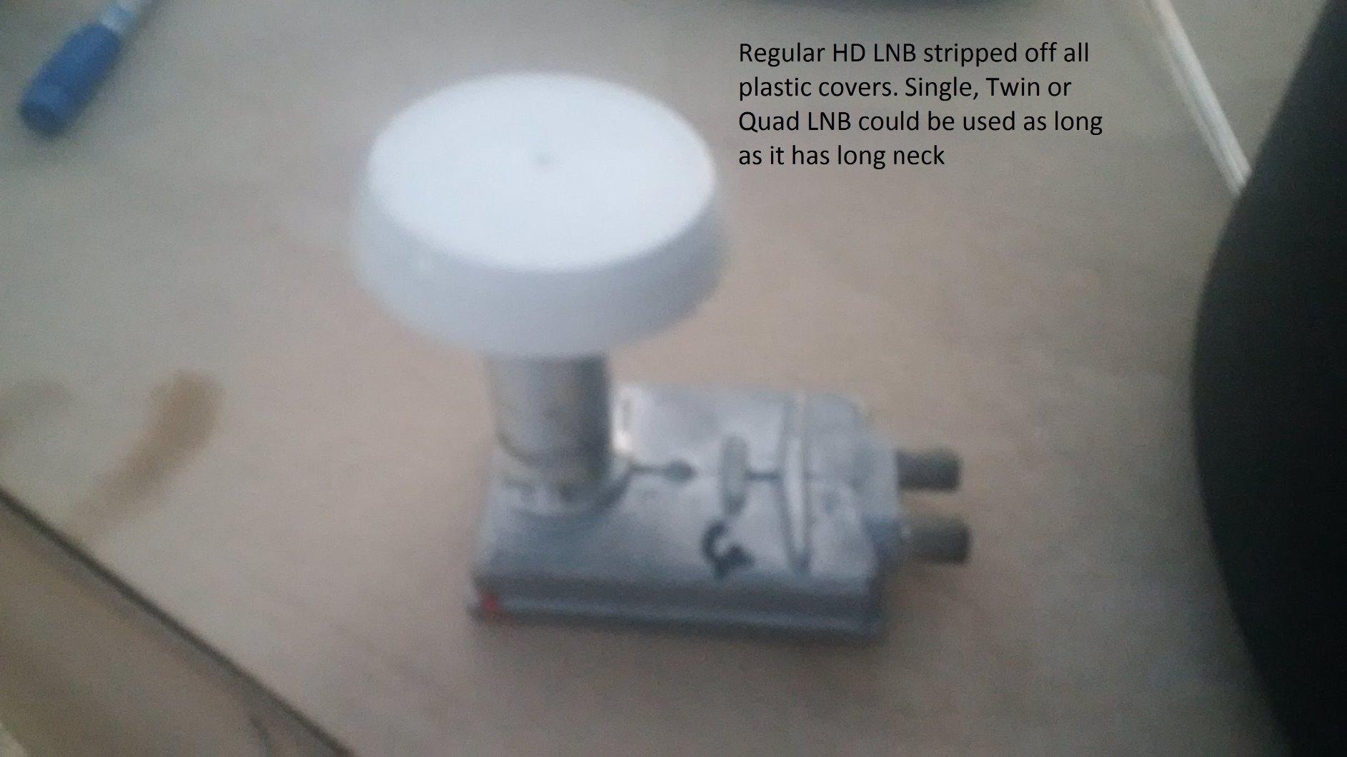

Yes poeple have swapped the lnb for a ku band one but they require the older metal ones with a long neck like this one. They just cut the new lnb under the plastic top then sanded the neck to fit the mp1 hole. They also used a inline non powered passive signal amp.
In looking for one of these if simeone has one of these older metal ones I would be interested in purchasing it .
