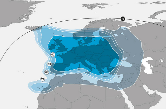

Excellent point - - exactly the value of Othernet. I can’t imagine a Musk-like satellite internet system would be allow to operate in Belarus either.
By the way - - the Othernet Astra 3B footprint is bigger than you illustrated
They are on the Ku-band Pan-Europe Beam. Ken (Long time Othernet supporter)
Are you sure it is the pan-euro beam?
I think the current beam is the regular central euro beam, I can cross check frequency ot the transponder/beam, it would make sense though by what Syed has said. I am almost certain that he has never explicitly said it is the pan euro beam.
I checked my notes,
‘My’ dreamcatcher is currently located near the Dead Sea by a friend of mine but the family is busy and has bad phone connectivity. According to them they can rx a reasonable SNR from the pan euro beam transponders but cant rx the transponders with the frequency that euro beam which the Othernet signal is on at all when they connect a DVB-S2 TV tuner to the LNB/dish and scan Astra 3B. I think we get wide beam lite due to the tight signal on an otherwise quiet slice of frequency which gives a great SNR through the LNB making even the edges able to RX with a bare LNB.

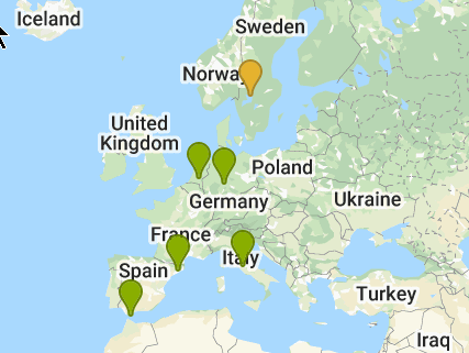

Yes - - I m sure. Syed @Syed will confirm this, but look at the location of a user in Gibraltar. He’s not in the Europe Beam, but he in the Pan-Europe beam. Ken
If you follow this chart below down to othernet’s feed at 11.6812420
https://www.lyngsat.com/Astra-3B.html
It says Europe beam not Pan-euro
Is our Gibraltar station using a dish?
I think Jim Watt @jimwatt is our user in Gibraltar, but can’t find his post talking about his setup. Maybe he’ll respond to this. Ken
We are on the Astra 3B Ku Wide Beam. The public contour maps are a little different from the ones I have seen directly from SES, which show hot spots over Germany and Poland. Gibraltar is within the coverage area, but it will take a larger antenna for reception.
I had a 1m dish spare in Gibraltar so am using that which get a very strong signal.
The footprint I found suggested a wide area coverage.
