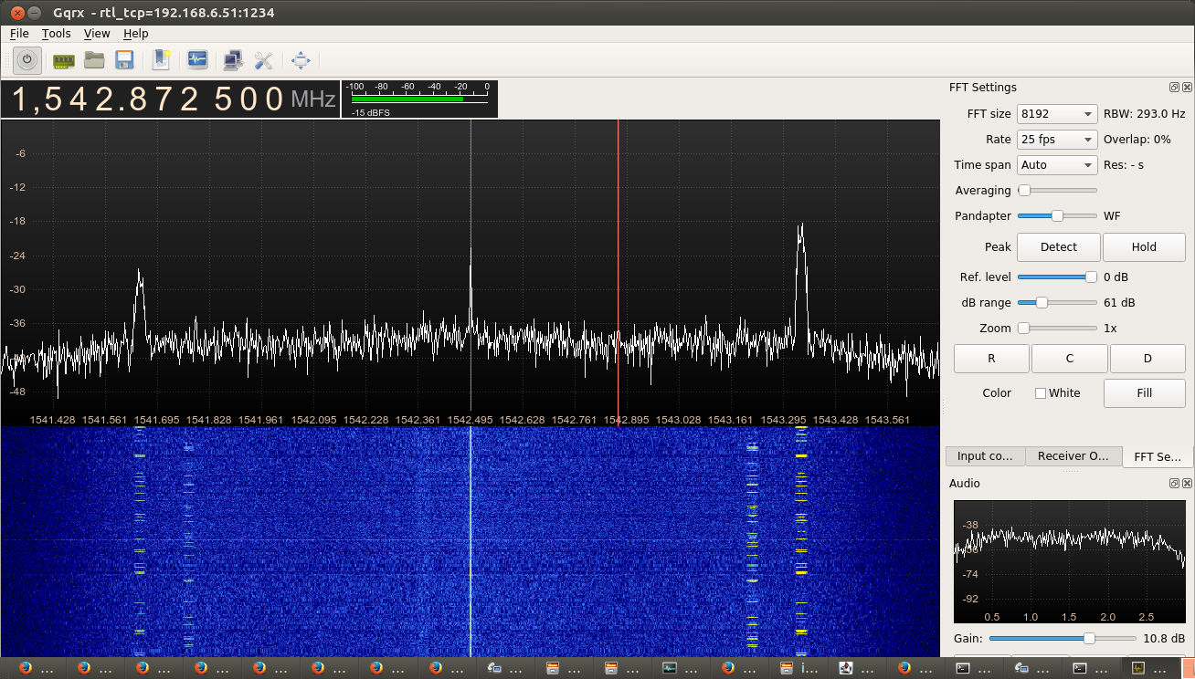

I see no signal at Outernet frequency 1539.8725 MHz… with the Outernet software or with GQRX.
I have the Elonics 4000 dongle attached to a Orange Pi and am using rtl_tcp -a 192.168.6.51 to send the dongle raw data over wifi to GQRX on my Ubuntu Laptop and using GQRX to decode the waveform information.
But with GQRX at 1542.8725 I see a very strong signal. (Does any one know what these signals are?

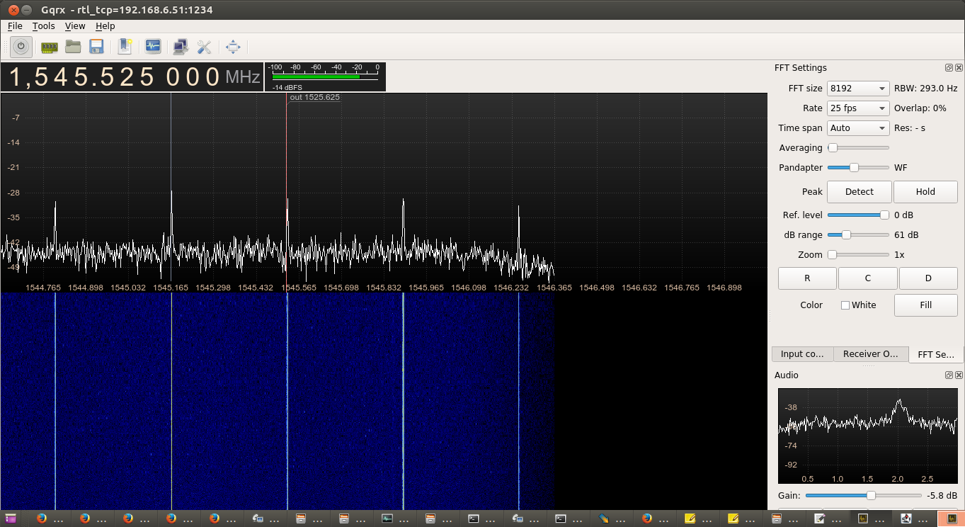

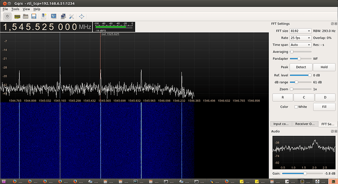

OK I changed my dongle to the RTL-SDR with a TCXO and it seems to work much better. on 1545,525 with GQRX but the Outernet decoder still wont permanently connect.

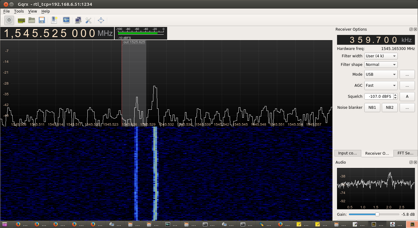

Here is a snapshot of GQRX.
Here is a zoomed in GQRX.
Can you highlight just 10 kHz?

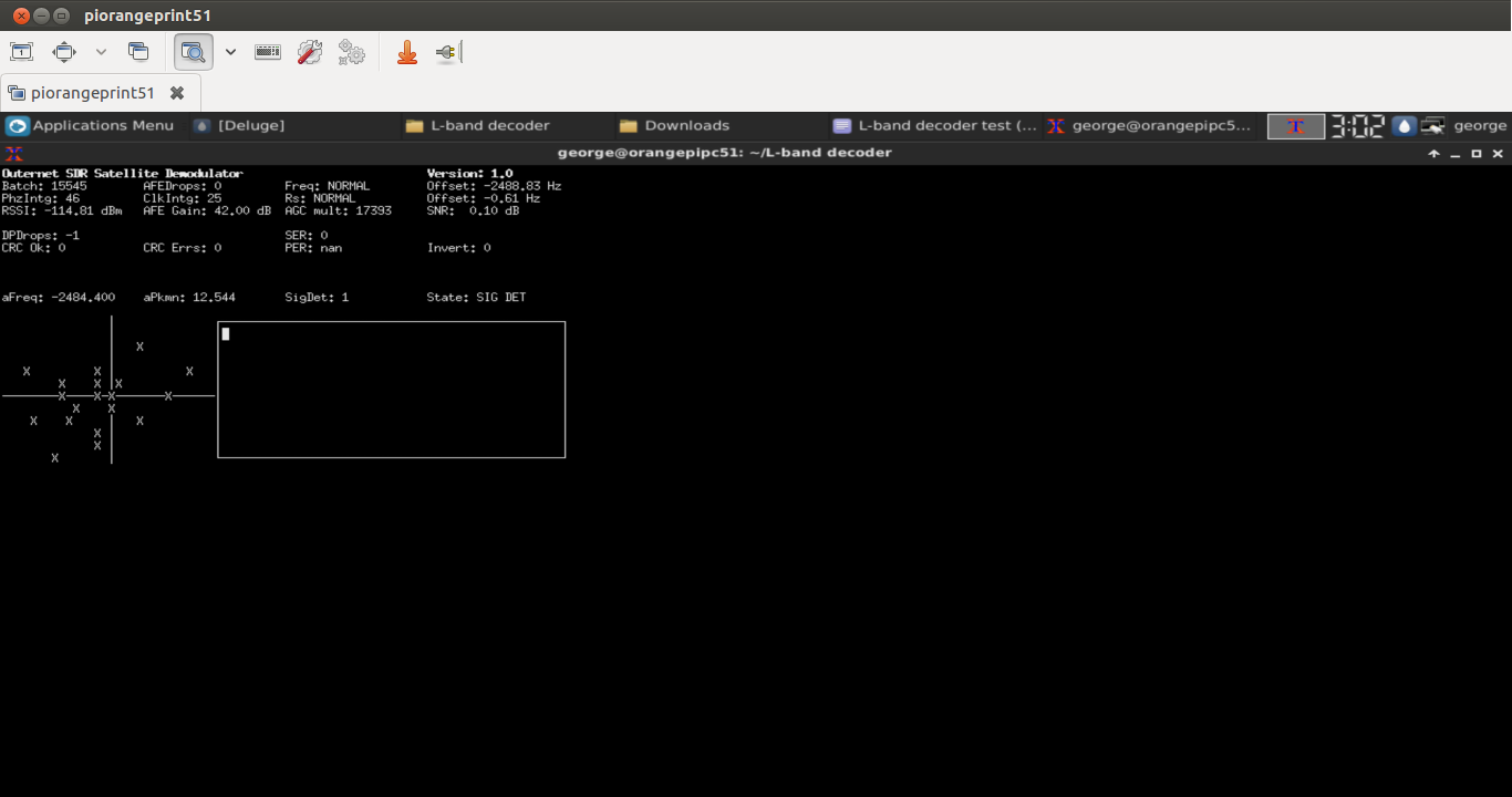

Are you receiving code lock on the demod? I don’t expect frame lock right now, but you should be seeing code lock on the debug screen.

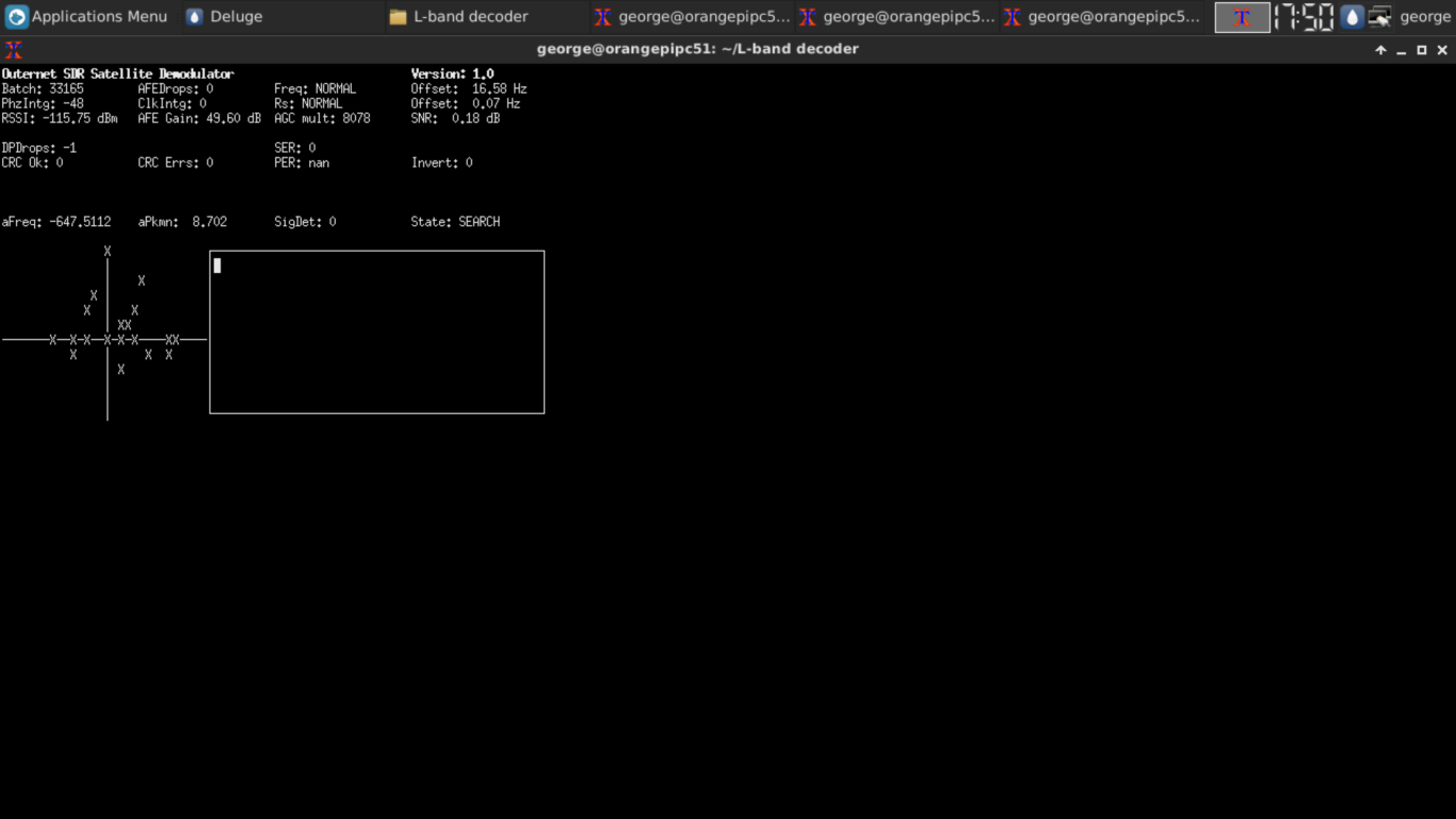

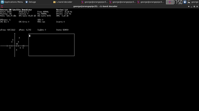

Here is a picture of the Outernet Demodulator trying to get a signal.
Sometimes it gets a signal and then after a second or two it looses it.
Something is wrong. It’s not getting a signal at all. It should be on code lock right away. In GQRX what is the SNR of the channel?
By the way, I think it’s going to be very difficult to receive the signal with only 20dB. We have not been able to close the link with less than 30dB from an LNA.

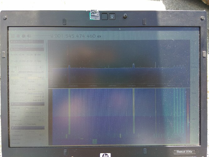

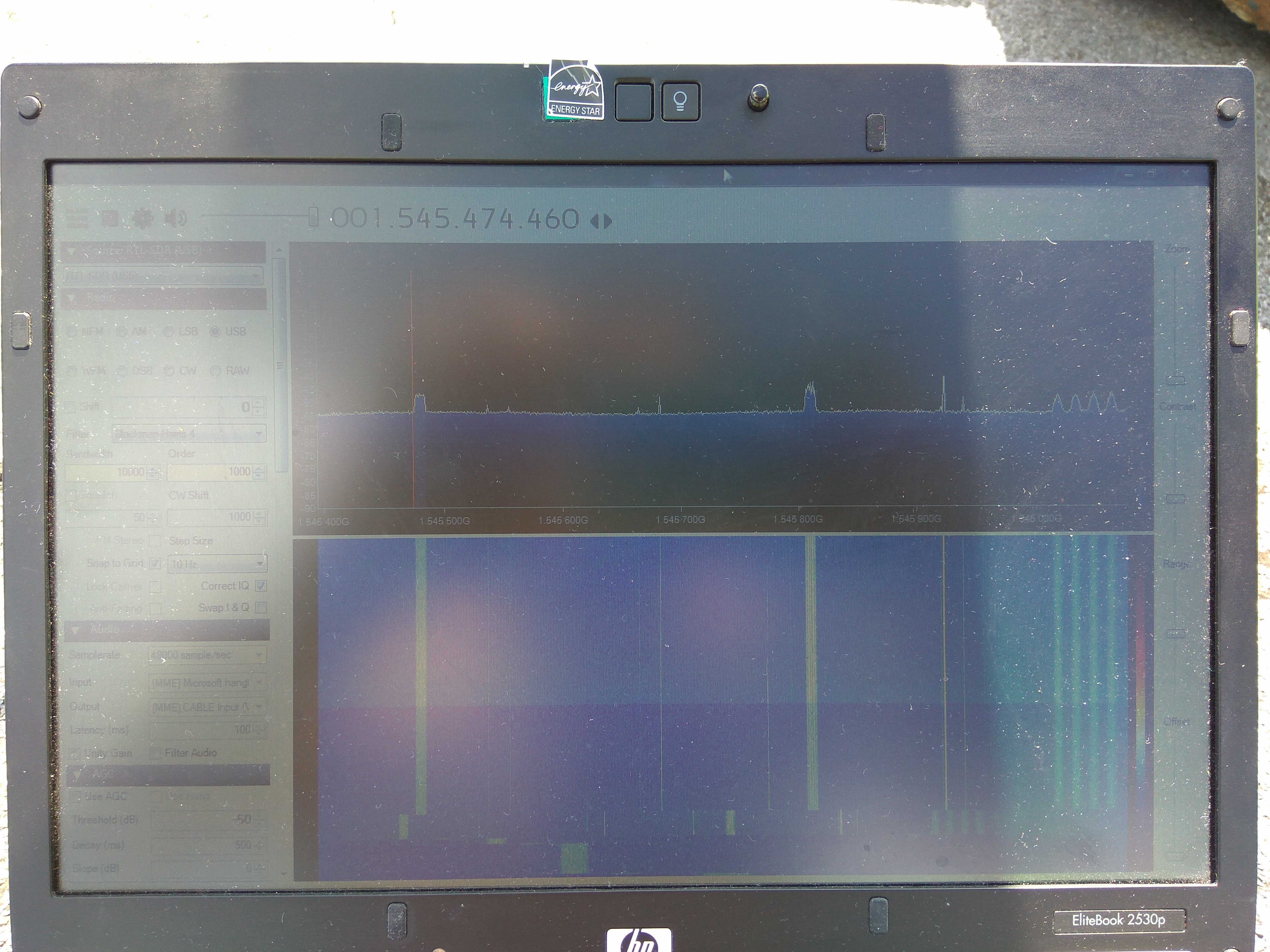

To obtain SNR, you are really just eyeballing the noise floor figure and the top of the channel. This is the new channel on IOR-64E viewed through SDR#. You can see a nice clean channel that should be very easy to lock on to.
