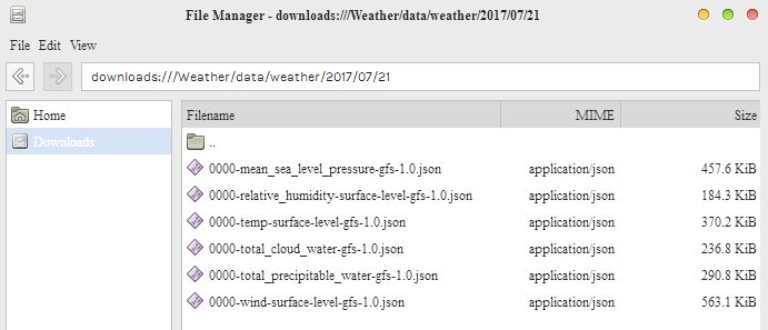

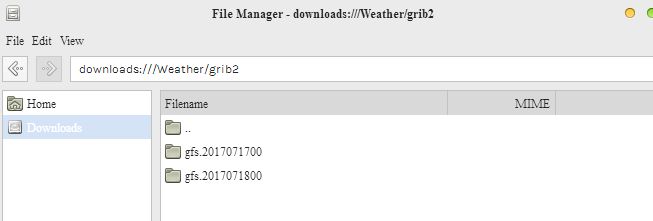

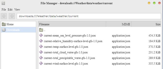

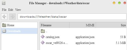

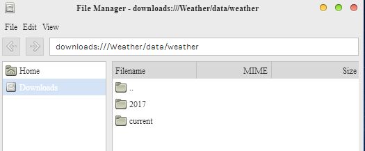

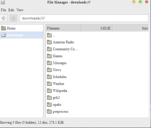

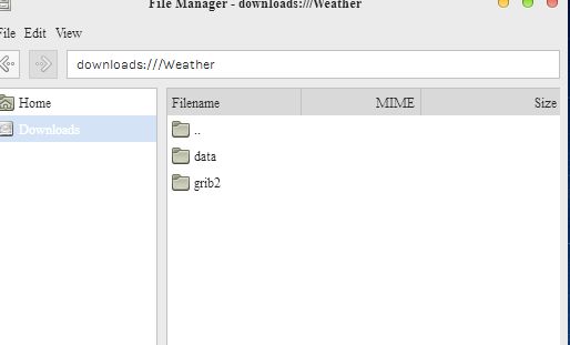

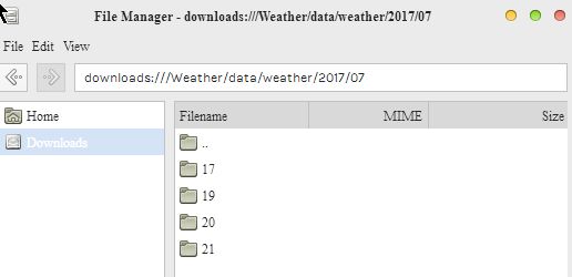

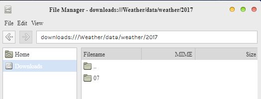

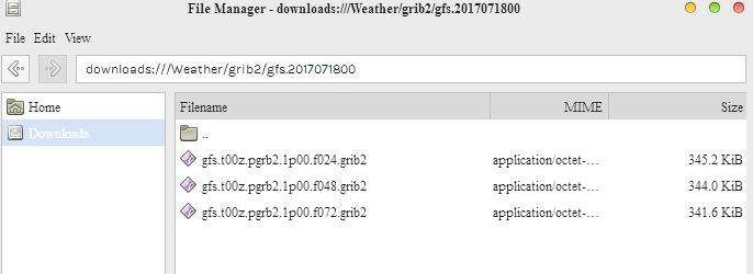

Hereâs my structure from Skylarkâs File Manager:
First Level -
Second Level -
Third Level Data -
Fourth Level Oscar -
Fifth Level Weather -
Sixth Level 2017 -
Seventh Level 07 -
Eight Level Contents of 21 -
Ninth Level Contents of Current -
Tenth Level (Back to Top) Grib files -
Eleventh Level Contents of gfs.2017071800

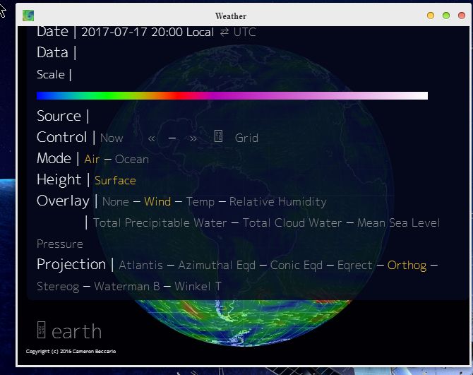

This all represents the last 18 hours of received Weather inputs from Outernet. I started with a clean Dreamcatcher SD card OS to get rid of old stuff. My Weather Tab looks as follows after running for 18 hours:
Hope this helps you. Ken
