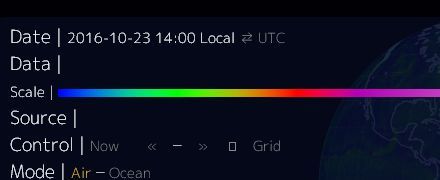

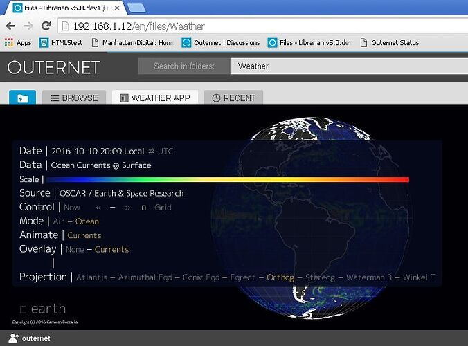

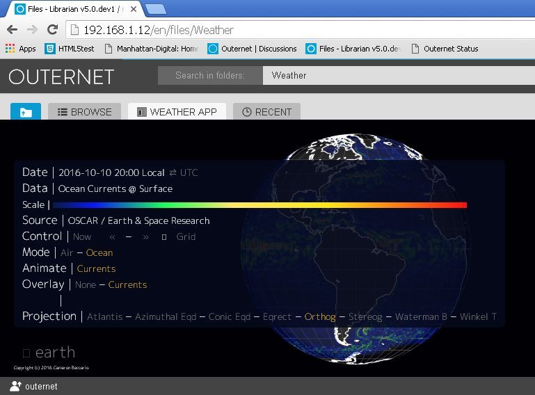

I’m using Chrome. I Reopened a new session and the Globe comes up in the default mode with 2016-10-17 14:00 Local.
Now doesn’t change it. Clicking on the >> advances me to 2016-10-18 14:00 Local, and << moves me back as far as 2016-10-12 14:00 Local.

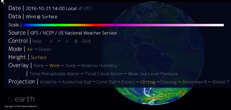

Now, I did the control shift R and got the 2016-10-21 14:00 Local display. I shut down Chrome and started it up again and the display came back to the current data screen. Clicking NOW always sends me back to 2016-10-21 14:00 Local
But using the << I can now only go back to 2016-10-18, and using the >> one time sends me to 2016-10-22 14:00 Local with a new data display, and hitting >> one more time sends me to 2016-10-23 with no data
Very curious - - I’m not sure what’s happened. I’ll take another look at tomorrow’s data tomorrow to see if my Lantern automatically updates and let you know. Ken
Clicking NOW make no change. Clicking the ahead button advances me to 22 Oct with animated data displayed (air currents are swirling), and clicking again brings me to 23 Oct with the previous data displayed, but not animated. Clicking NOW again brings me back to 21 Oct with animated data.

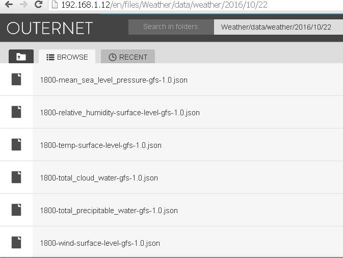

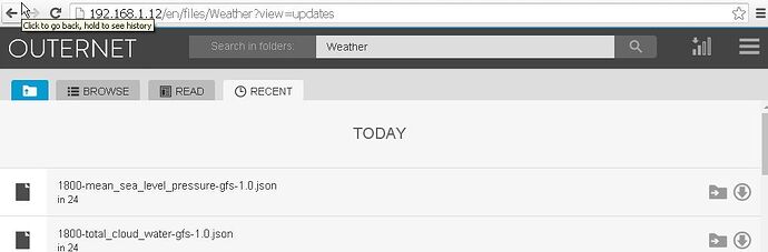

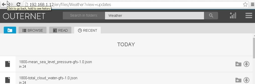

A manual CONTROL SHIFT R refreshes the page, but doesn’t change what is happening. All the data files (JSON and grib2) in RECENT are for 23 Oct.

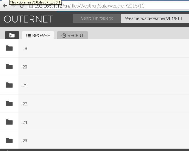

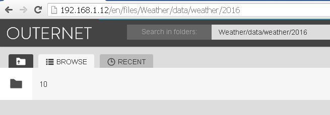

If I do likewise in 20, all the JSONs are for 17 Oct. In 14, all the JSONs are for 13 Oct. In 24, all the JSONs are for 23 Oct, and I don’t have a 25, but I have a 26 in which all the JSONs are for also for 23 Oct.

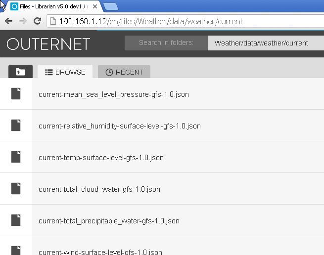

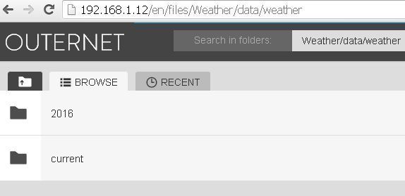

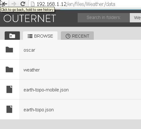

Going back up the file structure into CURRENT I just see the following JSONs all with 23 Oct data

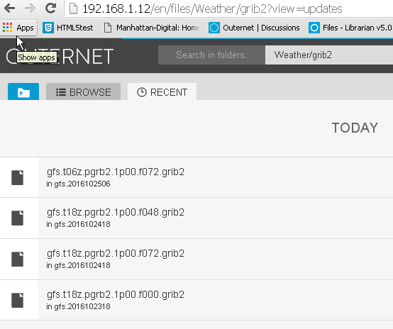

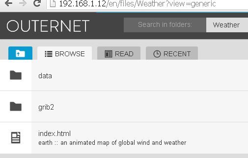

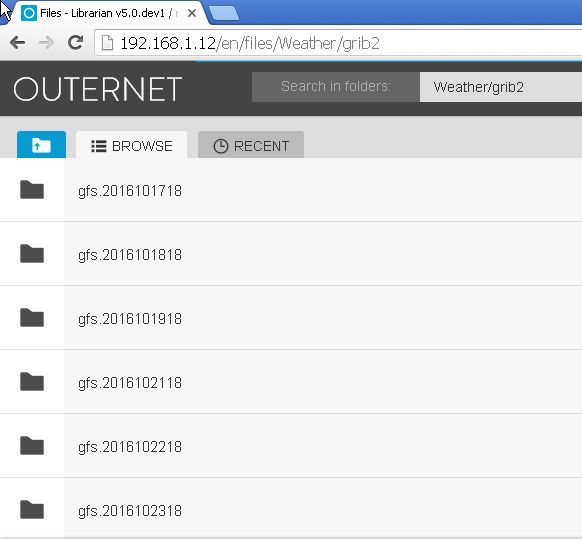

Could you also show me the Weather/grib2 folder? this the one that contains the source .grib2 files - the ones actually received over the satellite link. The json files are generated from the grib2 files.
It seems certain that you are not recieving all the weather files. specifically, for every date, you should have .grib2 files that say f000, f024, f048 and f072.

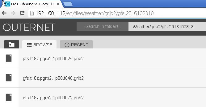

in this screenshot:
for example, I am missing the f072 file - which contains the predictions for 72 hours out from the date - the date is contained in the directory name - “gfs.2016102318” - so 23rd Oct, 2016. But as I did successfully recieve the f000 file, in my viewer click ‘now’ shows the 20161023 data, and I can also view the predictions for 24th (24 hours out, f024 file) and 25th (48 hours out, f048 file). but not 26th (72 hours out, f072 file, which is missing).
I’m missing f000 on the 23 Oct stream. In fact, the last time I received all 4 grib2 files was 13 Oct. I’m either getting 1, 2 or 3 - - never all 4 since 13 Oct. I’m going to download my App file and search it for these gribs to see if they are coming down to me and at what times. Ken
so 13th, 17th and 21st. That matches with the experience. I am not sure why that is. I did receive all of the f000 files, so I know that the sending side worked. The file for 23rd is actually still on the carousel, and I don’t know why you have not received it.
The 000 files are usually placed on the carousel just 5 minutes or so after midnight utc. That maps to about 7pm-ish your time, I think? I wonder if there is a regular disruption in the evening?
Though still, the file goes around the carousel multiple times, so you should still be receiving it.

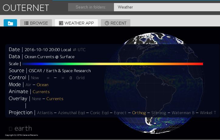

Surprise of surprises. On first look at my Weather App (in the Air mode), I automatically displayed weather for 2016-10-23 18:00 UTC. Using the >> button, I could move forward to 24, 25, 26, and 27 with animated graphics for 18:00 UTC. It is now 25 Oct 12:00 UTC! Using the >> cursor to go to Oct 28 continued the display of a non-animated 27 Oct weather report. In the Ocean mode, I get no data and my display locks up. Here’s what came down last night

Due to your bug reports, I also noticed a problem with the ocean data, which I have now fixed. You should see new data today.

ocean data is only rarely updated by NOAA. Officially the data is updated once a week, but till now I have not seen any changes in the data. Seems currents don’t really change that frequently.
