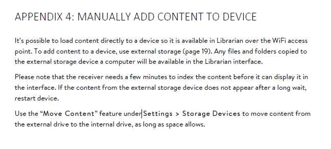

Can’t I do it with Windows explorer as normal usb stick with rxOS folders?
in the user manual it says as image below but it i can’t move the data from the usb stick to Raspberry sd card.

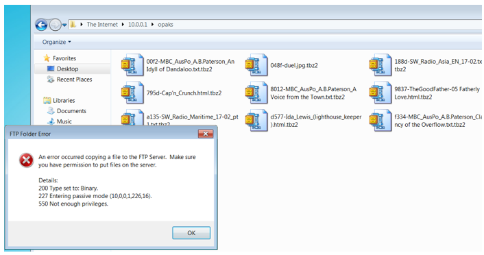

You can use windows explorer. Type this into windows explorer address bar: ftp:/"ip of raspberry pi"
without quotes. Then right click, login as, use your outernet login. You should then be able to drag and drop the file into the opaks folder.
it says there is no enough permission.
Did you sign in?
@demandzm YES!
Can you post a screenshot of the message?
I meant the message telling you that you don’t have permissions to access ftp.
unfortunately, it doesn’t appear anymore !!

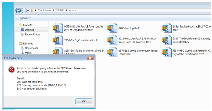

Good, does that mean it is working?
this is the message
even I have the weather app in the main folder but I can’t move it within the device

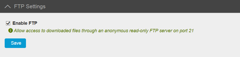

The FTP on the Librarian is specifically “Read Only” as it says in the top screenshot, thus you can write a file like that.
I think you will have to log in using ssh and then put the file there…
