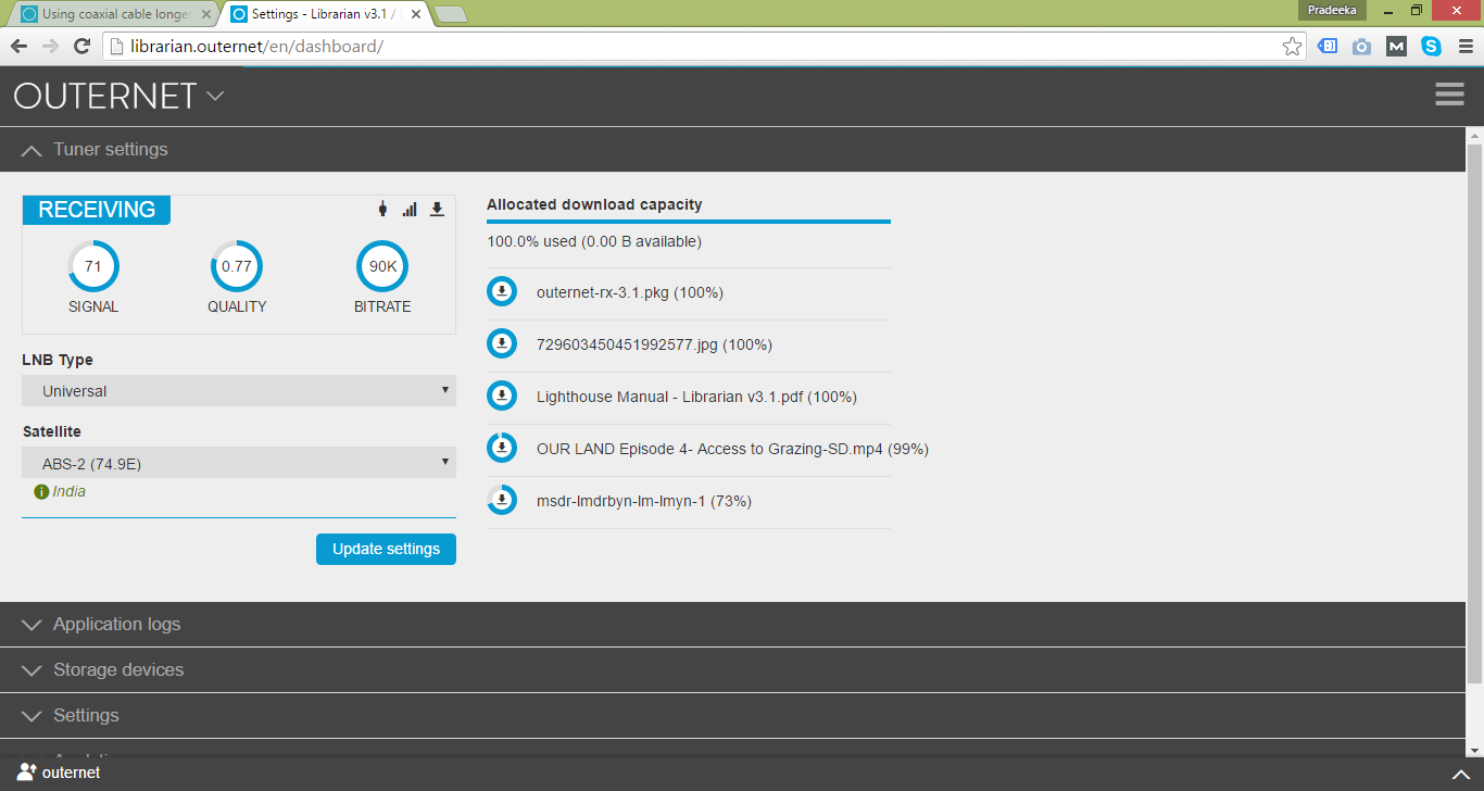

Hi Ken,
Actually we can increase the signal and quality by reducing the cable length. I’m using about 20ft cable and here is the tuner settings page.
