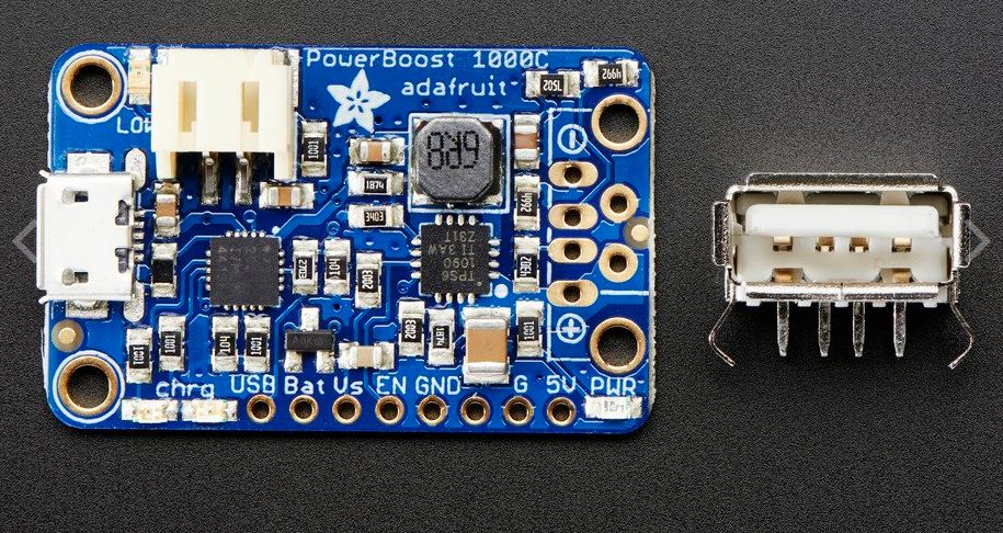

I’m experimenting with a less costly Uninterrupted Power Supply (UPS) solution for the Dreamcatcher v3.05 using a 5,300 mAh LiPo. I’ve tried it before with some success, but believe it is worth resurrecting. The Adafruit Power Boost 1000 costs $19.95 (and you have to install the USB plug on the right side of the circuit board) - -
coupled with a Boston Power Swing 5300 cost $15.99 - -
The combination will supply the DC a reliable 1 amp of power at 5.2 vdc while keeping the LiPo charged. Loss of power to the Adafruit enables the LiPo to run the DC for about 4 hours. Ken

I have discovered the The Adafruit Power Boost 1000 cannot sustain the Dreamcatcher v3.05’s BIas-T voltage to the LNB. The DC stays connected to my client Lan and lets me in fine, but the Bias-T shuts down.
I believe this is because the Adafruit is being maxed out at 1 amp running/charging. I’m looking at another idea Jerry @maxboysdad has suggested which runs at 2.4 amps. Ken
