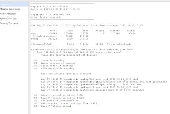

Welcome to Othernet, Johnny! This certainly isn’t junk, nor is it a dead project. It does take a little persistence at first to get everything running correctly. Don’t invest in a dish just yet. You didn’t mention where you are located, however, so we would need your city and state to be able to discuss the pointing of your LNB. Are you able to see the Skylark 5.8 opening screen on your web browser? If so, click on the blue square in the upper left corner of the screen, and open “Log Viewer” and then select Diagnostics. At the bottom of the display there are some figures for the LNB power. Check this out and let us know here what you see there. It should look something like this:

Please check your source voltage with a digital meter to be sure it is at least 5.0 volts. We have experienced a lot of power units that have sufficient current (2.5A), but when connected to the circuit, the voltage is under 5.0. My first power unit did that after I had run it for several months, and it drove me nuts until we measured it and found it to be only 4.97. From that time forward, I have used an official Raspberry Pi power supply (5.1 volts), with no problems.
