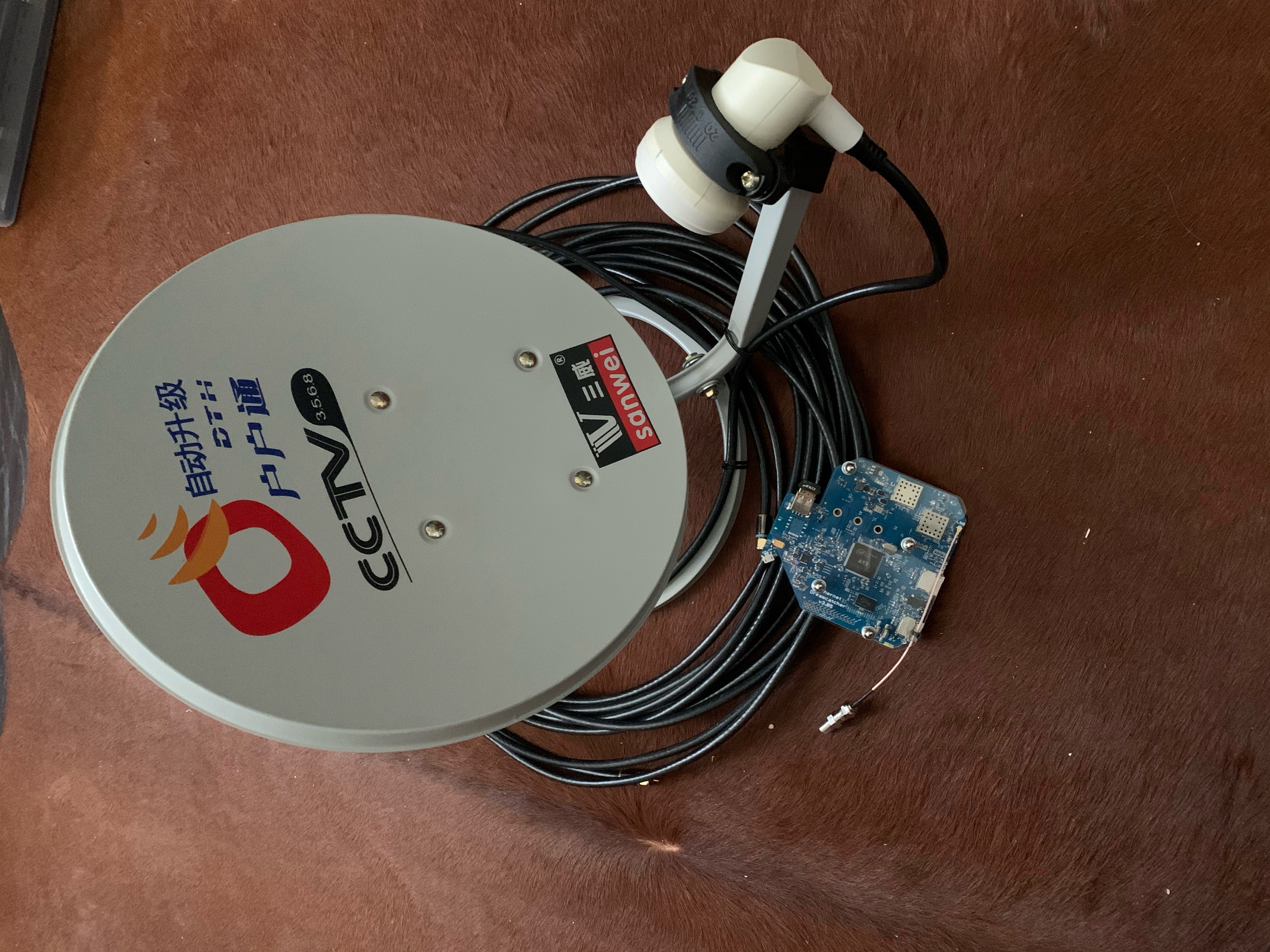

So I am embarrassed as to how much time I have spent trying to get othernet to work. I have read and reread user guides. I have good bias t and current. I have used tysons freq finder up to 200 steps and realign a 35cm dish many times. For where i am at it is 132.9 azi 36.8 ele and -36.7 skew. I have been able to get the ant 6 led to blink pretty fast heartbeat like it wants to lock but no luck. I have even used the app to manual adjust freq 5kHz steps almost over the 100kHz “drift” of a dual low. started at 12.0894 freq and beam 36. I am pretty good with all of this stuff but I will say that it shouldn’t be this hard. Ken or tyson do you have any suggestions before I throw in the towel and sell the setup. I have many other HAM radio projects on the backburner trying to get this up. So thanks for any help.

So i used the freq app again and scanned after rechecking dish alignment. as it is scanning through freq I am watching ant 6 led it blinks almost non stop (very fast as its passing signals then slows again) but it never gets any packets or lock, i have tysons freq finder app and DC tuner app open next to each other so i can see them both, still no luck. I am thinking that the 10 steps in your app should be enough for initial lock before fine tune. 10 steps at 10kHZ that’s 100kHZ below and above 12.0894. Hate to throw in the towel but I think I might be done. This is the second time since I have gotten it that I have spent days with no luck. both bare LNB and 35cm satellite.

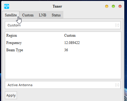

Then, when you started your setup, did you set your satellite to Custom, and click Apply? Ken
