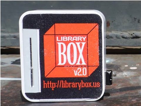

If the DC is connected to a more powerful router a community chat app might be useful. The library box has a similar feature.
